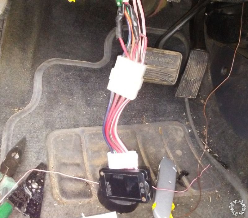

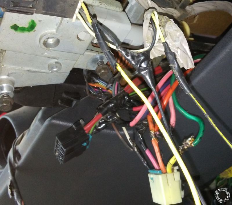

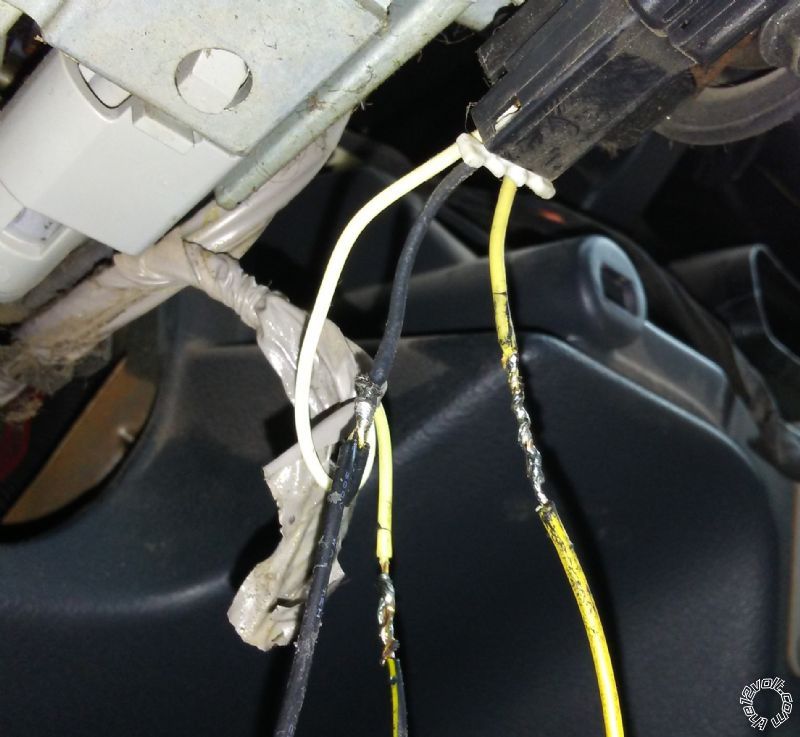

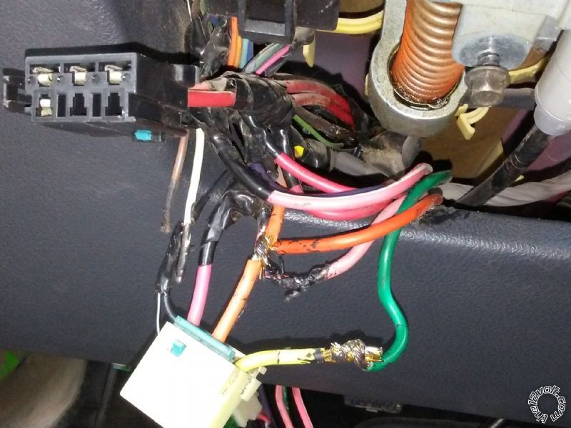

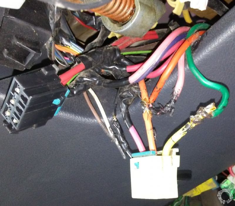

It has been a while since I have been able to tackle this disaster where this guy tried to install a remote starter for my vehicle. I read up on the remote starter system and started tracing out the wires and cutting patched wires and securing them with liquid electrical tape and applying electrical for further security.
I am now faced with the thicker wires coming from the satalite remote unit of the starter. I took apart the steering column collar so I can see better where he tapped in. Wow, what a mess he made. These pictures (below) show what I see now as I removed the electrical tape exposing the splices that he made. I pulled the two plugs out of the connectors just below the steering column so I can have a better view (along with you) of what I am facing.
So my question is "Help" where do I go from here. I can see the heavier gauge wires leading to the remote satellite device but some wires from the steering column were actually cut and replaced with the remote start wires.
Can one of you gurus please take a look at this and give me some idea of where I go from here.
Also note where the green wire from the satalite module is attached to the wire from the steering column but where it the original wire now? Where should I be looking?
Thanks so much. If you need a better picture let me know.

Yep, that's a mess.
The other end of the yellow wire is attached to the purple wire on the R/S harness. I can see the purple wire in the pic.
I've had to fix a couple of messes like the one you have here. I went junk-yarding, and found ignition switch pigtails from an unmolested car. I cut the connectors off with as much extra wire as I could. I spliced the new pigtails into the car using uninsulated crimp connectors, soldered them, and slid heatshrink tubing up and insulated the splice. When I reinstalled the factory split loom, the repair was undetectable, because the splices were within the loom.
I don't know what car-lines use the same ignition switch as your Cavilier, but I'm sure there are several, and for a bunch of years. Don't limit your search to same make, year and model, because there are certainly other donor models and years with the same switch and connectors.
