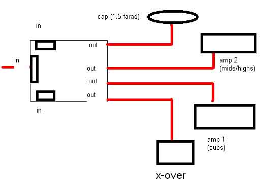

1.  is it ok to run a wire from my distribution block to my capacitor.  i.e. - it will be treated as if it is another amp wired to the OUT portion of the dist. block.  I have 2 amps and a xover wired to the same block.

Posted By: macka
Date Posted: November 26, 2003 at 3:15 PM
Ok, so back to my questions...
bberman1-
so this will not work well (I guess this is how someone told him to wire it):
posted_image
so...should I just put the cap on the distro and then run the sub amp off of that?  Better yet, with what I have what is the best way to wire it, in your opinion.

Posted By: bberman1
Date Posted: November 26, 2003 at 3:32 PM
EzekialPhenix your welcome.
Maka no your diagram will not work, you need to put the cap in line with the power. So either wire it in on the power line coming in to the distribution block (the way I would do it). Or you can wire it on the line between the disro and the amp. (This will only benefit the amp that is line with) Here is a general diagram of how to hook up a cap https://www.audiobahninc.com/tech/additional/cap_wiring.pdf

Posted By: forbidden
Date Posted: November 26, 2003 at 3:46 PM
Bberman dude, me thinks his wiring diagram will work just fine, current flows in both directions, not in and then out a different line. The only change I would make is to wire the cap to the other side of the distribution block (the second or third input) unless it is a fused distribution block, then he may want to take advatage of a fuse to protect the cap and the equipment should there be a short between the cap and somewhere else. This method also allows a better degree of safety when working on your system, disconnect the fuse at the battery and disconnect the fuse at the distribution, no more current! I have used this setup many times with all types of caps, they work for me no different than the method you describe. Missed most of this thread as I am on the West coast (Vancouver Island, B.C.) so usually I can respond a little later at night as compared to a full e-mail box in the morning. Tell me what you think about how I wired in a cap in this method.

Posted By: bberman1
Date Posted: November 26, 2003 at 4:05 PM
Forbidden I understand that current flows both ways but for some reason my thinking is off. I always install the cap either before the distro or inline with the amp. I have never thought to install it on its own leg on the distro block, we learn something new every day

Posted By: DYohn
Date Posted: November 27, 2003 at 9:36 AM
IMO the cap will work fine as diagrammed and it should be grounded seperately and NOT go through a ground distru block.  Just make sure it is a good, solid, bare metal ground.  You will not set up an audible ground loop.

Posted By: DYohn
Date Posted: November 27, 2003 at 2:28 PM
Noise generated in the ground connection of a sub amp can affect the power stability of other amps.  So the degredation of SQ is found in the mids/highs.  I've seen dramatic differences in some setups by moving the sub amps ground to it's own location.
Caps can produce instantaneous current surges that exceed the capability of many distru blocks, thus my suggestion that they be grounded seperately.
Date Posted: November 27, 2003 at 2:40 PM
Bang on with the scenario about current surge dude, that is why I use the Lightning Audio cap block, it has no fuses in it and was designed exclusively to work with a cap and up to 4 amnplifiers. I will pull in some of my past installs to check the scenario that you are showing above. I have never ever heard of noise generated by a connection as you are talking about. Noise generated by a bad connection, yes, but noise generated by a good connection, no. Thanks for the info and again sorry if I set you off.
