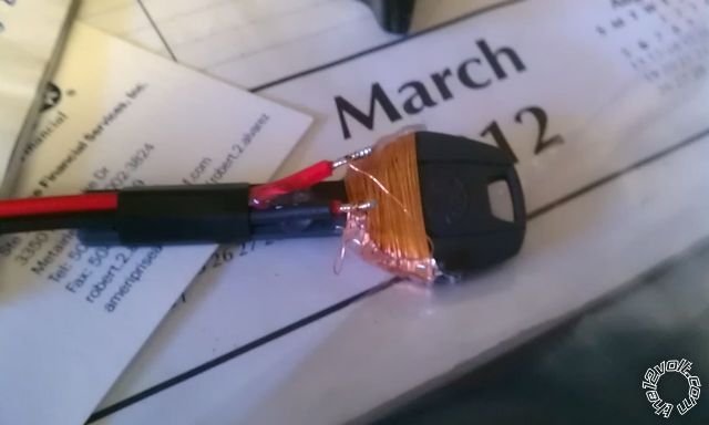

posted_image
Posted By: soundnsecurity
Date Posted: March 26, 2012 at 10:12 AM
took a picture of what i made this morning. does anyone think this will work? i will run this through a relay and im not sure if i should wire it in series or parallel to the two wires from the factory ring.

i have never had luck wrapping only the bottle end of the key shaft. I tend to wrap the entire key head, then cover it with electrical tape.
Ted
i should have taken a picture of the back of the key, the wrap mostly covers the spot where the chip is made into the key. i plan to tape it up, i just have it like that so i could get a good picture of what i did. i should be able to install it Wednesday. as for the instructions on the 556u, i dont have any. this was a 556 that we took off of one of our own cars. it worked just fine when it was taken out but maybe it got damaged somehow while it was in the box we keep spare alarm parts in.
ill wire it in series and see what happens. thanks everybody for your help.

Why has sound security gone off the tracks wrapping that key, it's an awfully shoddy method compared to a 556 or the Comp. equivalent.

just an update, my hand hand bypass worked like a champ. wired the two wires in series with the factory wires and installed a relay to separate them and activated it with the status output and it starts perfectly now. thanks for everyones guidance on this issue.
