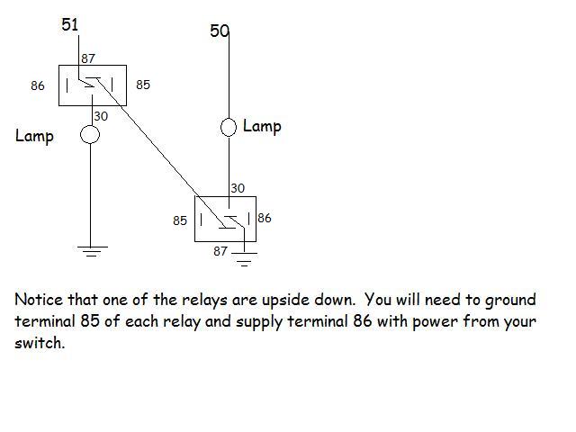

hey guys just wondering if you guys can help me out here
I would like to wire up my foglights to turn on when i disengage my park brakes(just like a DRL system)but with only half the intensity. Also can produce its full intensity whenever i have the foglight switch on with my headlights.
Im doin this with the factory installed fog lights and it is currently switched on by activating my low beam and goes off with flash pass.

How many wires are there coming out of each FogLight?  If there is only one wire coming from each, the half brightness thing will be a problem.

nope there is 2 wires
heres is a diagram

Platinum - Posts: 13,723
Posted: April 05, 2008 at 6:26 PM / IP Logged
2007 sentra drl -- posted image.
Posted: April 06, 2008 at 8:45 AM / IP Logged
You posted a diagram with your fog lights on the diagram. The 50 and 51 on the top of my drawing are the same 50 and 51 on your diagram. I asked if EACH foglight had 2 wires on it, you answered yes. Do you know anyone that is semi familiar with wiring up a relay?
I forgot you wanted to have them activate via the parking brake. That will be an easy modification. Get the rest of it figured out and I can modify the instructions for terminals 85 and 86
It is also going to take 1 more relay to do this. What I drew was switching the lights from parallel to series to achieve half brightness. We will need 1 more relay to provide 12 volts to these 2 relays. If you find someone that can make heads or tails out of the previous diagram, let me know and I can draw you another one.
