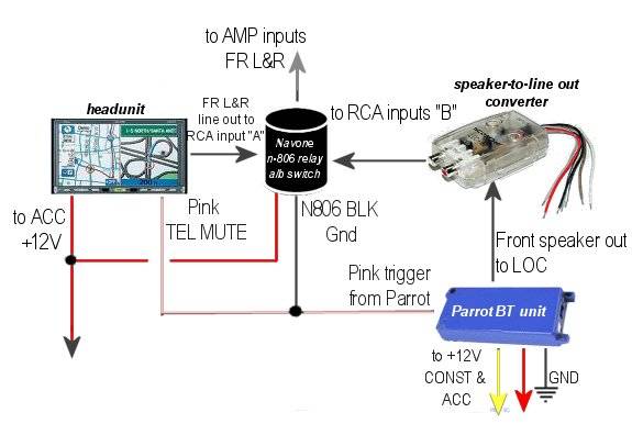

I've finally found a solution, that is simple and cost-effective, of hooking up the Parrot Bluetooth modules to the Eclipse AVN series of head units.
These BT modules were not designed with aftermarket amps in mind, so I had to find a solution that would switch between the head unit and the bluetooth module. I also wanted to switch at the LINE level, instead of the speaker level. The wiring would be easier, since all the line level wiring is conveniently behind the headunit in car.
The solution, as so many have said, was wiring a DPDT relay in line. Since I was working with line level outputs, I didn't have to find a relay that needed to handle high wattage. The relay I found was a simply electronic A/B switch from Navone Engineering (the N-806). It's a DPDT relay with silver contacts that allows one to switch a Left and Right (L/R) channel from two sources. It has five wires on it:
-One pair of RCA inputs "A" that are by default "on";
-One pair of RCA inputs "B" that switch when the coil of the relay is energized;
-One pair of RCA outputs that connect to the downstream AMP;
-One red wire Power / Trigger wire;
-and one black GDN wire.
Basically, the setup was simple:
1- wire the FR L&R speaker outputs (rated at 6W) of my Parrot BT module to a speaker-to-line out converter (LOC). In turn this gets wired to the RCA input "B" of the N806.
2- wire the FR L&R Eclipse line outputs direct to the N806 RCA input "A".
3- wire the RED trigger wire of N806 to ignition (ACC) +12V.
4- wire the BLK gdn wire of N806 to the Eclipse pink TEL MUTE, and to the pink TEL MUTE (trigger) of the Bluetooth module.
5- wire the FR L&R RCA outputs from the N806 to the AMP.
So, when there is no phone call, the coil of the relay is not energized, and the Eclipse line out signal is free to go to the amplifier. When a phone call is received, it triggers the Bluetooth module to put the pink TEL MUTE to GND ground, which at the same times sends a GND to the Eclipse that puts it into "MUTE" mode, and *also* grounds the N806 relay, which energizes the coil, allows the signal from Input "B" to be active and flow thru to the amplifier.
Cost of the N806 is about $25. Great solution, highly recommended.
I've attached a simplified schematic for this.
Mikster
audio grade relays? -- posted image.
