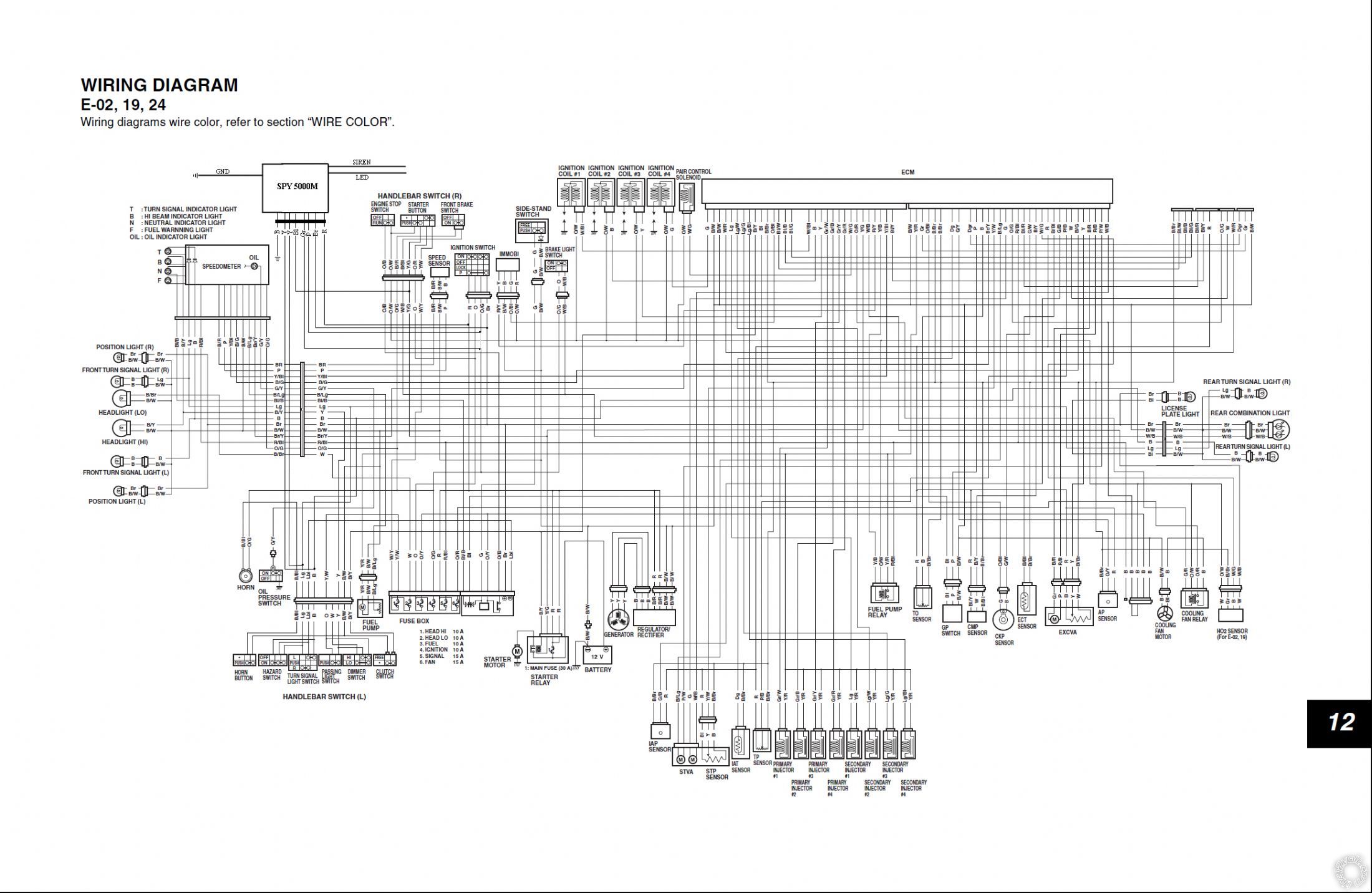

Just bought one of these myself. Compared notes in this thread with my own, and added the Spy5000m unit to my factory wiring diagram. Haven't installed yet so I'm not sure this is correct, but if someone could take a look at it for me, I'd much appreciate it!
2008 Suzuki GSXR600 Spy Alarm - Page 3 -- posted image.
