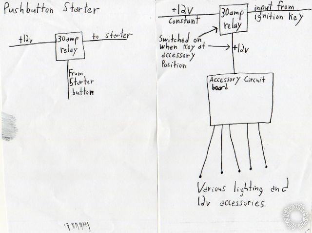

I want to add an accessory fuse panel in my car for all my 12V accessories. I'm going to have a decent gauge wire going to the relay and the same going to the fuse panel. I want the fuse panel to be hot only when the key is in the acc. position. Is my wiring diagram correct? Also, I have a push button start without a relay. The starter takes a lot of juice and right now it's going through the button which i'm assuming isn't too good. I want to put in a relay so the relay can take the amperage and not the button. Is my starter button diagram correct? Thanks everyone.
