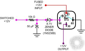

I threw the following together quickly (much appreciated if someone would be so kind as to check to make sure I got it correct) but it should be what you want.
constant to momentary with a microrelay -- posted image.
91stt
Silver - Posts: 564
Joined: May 24, 2006
Posted: May 06, 2010 at 4:51 PM / IP Logged
You may not be able to find a 50μF capacitor, so you may need to substitute a 47μF instead. It will still give you about a 500 ms delay.

I actually have a 50µF capacitor, but it is bipolar. Could I just add a diode between it and ground with the stripe towards the cap to make it work?
May I ask why the zener is not pointing towards the relay?
Unfortunately that won't work because the amount of current through the inline resistor won't be enough to drive the relay directly.
To do this you'd need a transistor driver.
This is a thread for momentary to timed pulse output stretching, but it's a simple matter to rearrange things for delayed on purposes.

dualsport
Silver - Posts: 983
Joined: September 27, 2005
Posted: May 08, 2010 at 3:32 PM / IP Logged
If you basically use the configuration above, but move the diode (a standard 1N4001 will do) and place it in parallel with the resistor (pointing to the left), you'll have a timed output you can feed to the transistor relay driver (refer to the drawing on the other post)
When your input goes high, it'll start charging up the capacitor through the resistor. Once the voltage reaches the turn on point of the transistor, about 3 or 4 volts, it'll turn on and switch the relay on.
when you turn off the signal, the diode will discharge the cap immediately and it should turn off right away.
