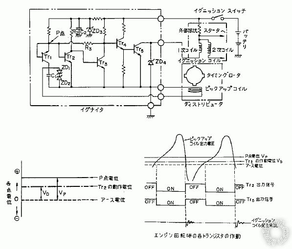

And then there is my favourite circuit below from a 1970's engine (Isuzu G200W twincam).
The trigger is merely TR1 & TR2.
TR1 is a constant-current source for pickup coil, and TR2 does the switching.
The other transistors amplify to dive the ignition coil.
I like it because it is simple and no voltage trimming is required.
And it imitates Kettering's dwell.
Alas no circuit values, but shouldn't be too tricky for electronic gurus. (These days you would use a MOSFET to drive the Ignition Coil instead of TR's 4 & 5, and maybe TR3.)

It doesn't matter - so does the above.... (it's the full ignition circuit).

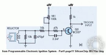

Otherwise an alternate trigger circuit commonly used in Silicon Chip (magazine) projects...

These days MOSFETS are usually used instead of transistors.
And usually the 2N3055 wasn't used, but others (which I'd have to look up).

I have seen this trigger circuit before but as it is, do i just connect the trigger input connection straight to the coil negative? and what exactly does the pot control in the circuit?

That is merely a trigger circuit. A BC337 only handles max 800mA - a coil may need 8A but usually less.
Like TR2 or TR3 in the old Isuzu sensor circuit, it needs buffering to switch a coil. Probably MOSFETs are the cheapest/simplest solution.
The trim-pot is to cater for different sensors (coils) and is usually adjusted to that Q5 is just switched on when there is no signal from the pickup coil. (See - I told you the Isuzu version was good - +12V supply; no adjustments; and by design triggers close to zero volts.)
