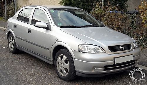

Sorry about this. In addition to the two posts above, here is a picture of the model of car. I assumed they were sold in the US, but cannot seem to find its badge equivalent there.
scs frigette 3342 -- posted image.
Is there a model name for it in the states?
