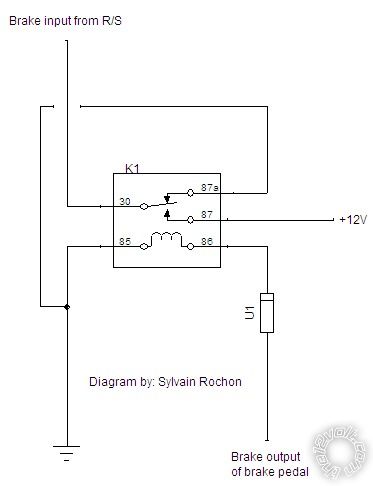

What is untrue Howie....domelight connection? One thing that I would is to install a relay on the foot brake. If you have unwanted voltage/current feedbacking on the line, it's probably not enough to trigger the relay unless you press on the brake pedal.
U1 is a 1 amp diode

That is what I understood Howie, just wanted to confirm. One thing that just flashed me, the other day, I did a Toyota Yaris with no door locks, for the Viper to get into ready mode, we needed to simulate unlocking the door using the viper remote for it to get ready. I know that Compustar are like that but it was actually my first experience with a DEI product. It's true that there's not that many vehicle with no PDL. When I get a problem with either park brake or door pin issues, I don't waiste time on troubleshooting, I install relays and it solves my problem 9 out of 10.
