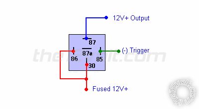

What is the output of terminal 87 in the diagram below if terminal 85 is engergized (12V+)?
spdt relay output converting polarity -- posted image.
I need to trigger a 12V+ output when an existing wire (backup lights 99 Ford Windstar) is switched from 12V+ to ground.
Thanks in advance!

New head-unit has a built-in screen and 12v+ switch to automatically display video from a backup camera when the vehicle is placed in reverse. Normally I would just tag into the reverse lamp at the tail-light so that when the light comes on, that sends 12V+ to the head-unit switch, but unfortunately the reverse lamps on my 99 windstar don't work that way... both inputs to the lamp are powered until the vehicle is put into reverse and then one side is grounded which turns the backup-lights on.
So basically, when that wire switches from 12v+ to ground, I need a 12V+ signal to be sent to the head-unit.

Connect 85 to the wire that goes negative when the vehicle is put in reverse.  I guess this is one of Ford's "Better Ideas"  This is the first vehicle I have seen with negative controlled reverse lights. Not that I install tons of backup cameras or nav units.

Thanks! I'll give it a shot.
