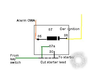

Ok I got everything working except for the relay that does the kill switch it's the three wires from the relay. Could someone tell me where the green, black, and yellow wires go?
summer_intern
Member - Posts: 8
Joined: June 10, 2011
Posted: June 11, 2011 at 9:11 PM / IP Logged
I tested alarm before trying to attach these wires. It worked flawless. After attaching wires like the diagram said... Nothing no longer worked. I used the white power 12v. Power cord for the brain. Should the yellow cord from the relay go to the other 12v wire?
Posted: June 12, 2011 at 4:07 AM / IP Logged
This is getting silly, have you actually read the alarm instructions?
It quite clearly states green to key side and black to starter side.
Yellow is an ignition input. Goes to a wire in your ignition switch loom that goes to 12V+ on turning your key to ignition and start positions.
The starter wire only goes to 12V+ on turning to the start. Cut this, key side to green and starter motor side to black. If your vehicle has the factory transponder immobiliser you won't need any of that any way, just connect the yellow wire to ignition that's mandatory for various reasons. Here is the correct diagram. starter_cut_dei.bmp
