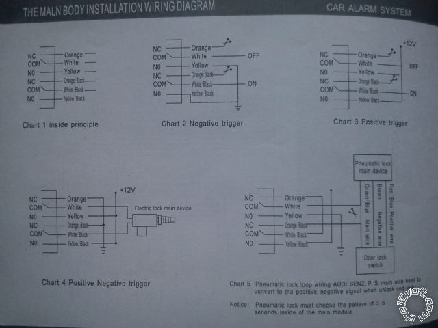

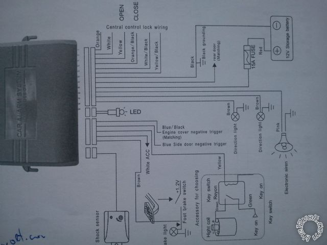

So, I uploaded my car alarm system - which I need only for door lock and unlock - that's all, because for my VW polo is only key.
I deeply hope that someone will help to install these alaram, so basic info about car :
* VW polo - 2002 - 1.4 TDI
And yeah, I searched in this forum for Polo 2002 wiring diagram but I didn't find !
vw polo door lock/unlock -- posted image.
I do no understand why there for door lock/unlock is 4 wires ? And how to connect to my Polo wiring !?

Look at the driver's floor loom, something like WHITE/ green and WHITE/ red, years since I did one, type 3 pos trigger, also in that loom if light is present, in the rear hatch, thin yellow black, trunk/hatch trigger, BROWN / white (one of 2, test) all door trigger, black for ignition, brown for ground (earth) BLACK/ white left and BLACK/ green right indicators. The red in that loom will also give you your 12v+ power supply.
That alarm looks really cheap and nasty.
Don't attempt anything from the left hand side, something like 32 screws to get the glove box out.

So all day I was messing around with my Polo and yes I found there 3 wiring , but I can't understand what I need to do , there are 5 wires from my cheap/nasty alarm system.
What should I do with these 5 wires ?
Posted: October 08, 2011 at 5:00 PM / IP Logged
Yellow and yellow/black to 12v+ constant (RED).
White to lock or unlock, WHITE/ black to lock or unlock (on, off? don't make me laugh).
Other two don't use. Even at £20 you're throwing your money away on that POS.
