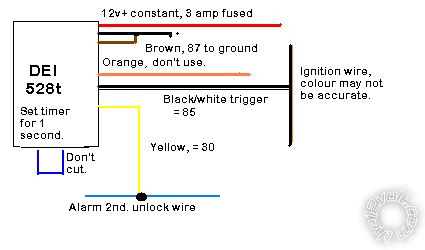

Posted: October 26, 2011 at 3:39 AM / IP Logged
Well, we're going to try to decide which one would be better for us. We are leaning more towards the 530.
For the doors, they works great when unlocking, and lock great. However, when we star the car, put it in drive and off handbrake, the doors lock automatically which was originally what we wanted. Then when we park the car, and turn the key off, only the driver's door unlocks. When I first wired this up without the progressive locking, it was a nice setup for all the doors to unlock at the same time when we stopped the vehicle. So now our passengers are left with their doors locked while the driver's is unlocked at park.
Do you know if there is a way to have all the doors unlock at the same time when we park and stop the car, or is this a standard feature in most modern vehicles?
Apart from that, it is great when locking and unlocking with the keyless. Having the driver's door unlock first before entering the vehicle is a good safety feature.
Posted: October 26, 2011 at 5:28 AM / IP Logged
We need to find a wire that goes to ground for a second when you turn off the ignition and use that to parallel into the second unlock wire.
Of course with DEI products you can program one of the spare aux outputs for that. Off hand, I can't think of anything to do it. Except run a feed from the ignition 1 to a 528t timer relay set to 1 second and pulse that output to the 2nd. unlock, thus unlocking the whole vehicle as you turn off the key.
Thus:- unlock_with_ignition..bmp

Posted: October 28, 2011 at 2:00 AM / IP Logged
Had a bit of a delay in things after a snow storm. Things are getting to normal now though.
Thanks for the info and all your help, you're quite knowledgeable. I found a Directed DEI 528T. I'm thinking that is the correct device. Tomorrow I'm going to try and see if I can program some of the alarm settings first. If I can't get the locks to work that way, then I'll order the 528T and wire that up according to your wiring diagram you gave.
