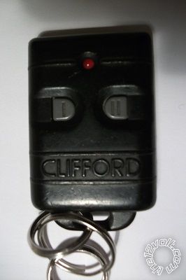

clifford id model? -- posted image.
Hi
I've just bought a 1994 Miata with a Clifford alarm system.  No manual and the seller didn't have a clue.  Can anyone tell me which model it is?  Then I might be able to understand all the wires and controlers.
Thanks Paul
Paul

Find the brain, it will be marked.
Posted: January 01, 2012 at 2:26 AM / IP Logged
Find the brain, should be pretty easy in that vehicle, it will have the model embossed on the casing. It's probably a Nova or a Novell or an early Eagle.

Thanks for all the replys.  I'm a true rookie on alarm systems.  When I got this car I was given a remote with not info.  There is one control on the consul a a couple of after market switches which don't seem to do anything.  I pulled the door panels off to replace speakers and found out I had remote door locks.  I pulled the center cover off the dash and found a fuse holder without a fuse.  Put in a fuse and the siren when off.  Disconected the siren and the buttons on the remote seem to work with the consul control.  I tried to trace the wires but between the factory wiring and at least three Clifford boxes with no number just Clifford on them it is pretty tight.  The whole works is zap strapped together.
I don't want to start pulllng things apart.  Actually I don't really need the alarm system but would like the remote door locks.
Now the wisdom I need:  Do I try to figure it out or just bypass everything and get myself a remote door kit and wire it into the car?
Thank again
Paul

Wiring colours chopped and changed, you can do anything you want but if you aren't prepared to get at the alarm in the first case......
When you replaced the fuse and the siren sounded, all you had to do was to press button 1 on the remote.
If the remote doesn't work, replace remote battery then turn on the ignition and flip that console switch X times. I say X times because without knowing what model we can't tell you so help us to help your self. And it's only the largest module you need to look at.
The others will be a shock sensor possibly on the steering column, a relay and possibly an early proximity detector in the centre console.
