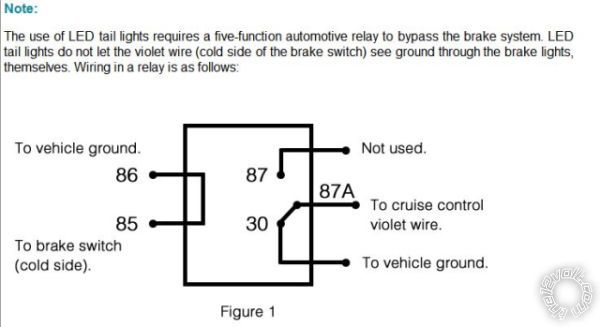

Almost embarrassed to post this. I have a 2005 Scion xb(auto trans) with the Rostra 250-1755. It has worked fine for years until I installed an led third brake light. Rostra has a fix. Install a spdt relay to present ground to the cruise, as it can't see it through the led tbl.
led third brake light relay -- posted image.
The relay is energizing when I hit the brake and the tbl works. The problem arises when I connect the violet wire from the Rostra-immediately blows the stop light fuse. It appears I need someone to tell me how to connect the violet correctly. I have the chassis grounds under control and the relay coil is functioning. I just don't know why the fuse blows when connecting gd to gd. Thank you.

The diagram shows Violet being connected to GND, yet the installation instructions (250-1755_Form4838.pdf) under Appendix A. ELECTRICAL TESTING (A4 - Power Brake Circuit) states "IGNITION “ON” 12VDC ON VIOLET WIRE", and your diagram above states "do not let the violet wire see ground...", yet it is connecting violet to GND when the brake lights are on.
The latter suggests stop bulbs which are a low resistance to GND.
IMO #30 of the relay should be to (the brake circuit's) +12V - not to GND.

Good eye, oldspark. I never saw the 12v indication for violet on the troubleshooting chart. I never had any problems when I installed it. Here, verbatim, is what the tech at Rostra sent me with the link to the relay fix: The use of LED taillights will cause our cruise control to stop working. For a workaround, please see the FAQ section on our website's "Support" page at the link below. You will find instructions on how to wire in an accessory relay to complete the circuitry from your brake switch that our cruise control needs to see before it will turn itself on.

But in this case, assuming brake bulbs, how the heck can adding a parallel LED array effect things? The added load is insignificant and electrically, the bulbs essentially short out the LEDs - ie, any rectification by the LEDs is bypassed via the bulbs. The resistance (& impedance) of the bulb/LED circuit will be indistinguishable from the bulbs alone (usually that is - ie, to within about 2%).
That's what attracted my reply. I wasn't even going to look at Rostra, but in case it was new confustigated thingamajiggy, I did. But it was a mere cruise control. (Yes - you mentioned "cruise", but to me that could have referred to audio or even a hair-blower.)
Then as I wrote my reply I got distracted into more & more detail. (Good! I reread your OP and diagram, and looked harder at the Rostra info. I often make the mistake of a quick read and total misunderstanding.)
And then I picked the two "don't ground the violet" info bits which IMO contradicted the relay wiring. (Obviously? Yes?)
Not that I am comfortable wiring violet (#30) direct to whatever +12V - you'd better wait for some confirmation first (though it "feels" pretty safe - if ground blows a fuse, the it is unlikely that +12V will do damage, but it might).
[ BTW - I added so much to my original reply that I deleted and reposted the modified reply. (For the reason I described in my earlier l-o-n-g 2nd reply to strikethrough.) ]
And not that I know what the violet is, but if it's a brake sensing input, isn't it strange that EVERY user would have to add a relay? If the cold side of the switch is bulbs, then violet sees ground through a 4 Ohm resistance if it's two ~21W bulbs. If it's a LED array, the resistance is probably well above 200 Ohms (plus a voltage drop across the LEDs), so why would LEDs be a problem if bulbs aren't?

Howard belatedly goes with ignore the relay and the LED brake light, all you are looking for is 12v coming from the switched side of the brake light to disengage the cruise control.
If the third brake light effects other things and I can't see how may I suggest a 1N4004 in line band towards the LED.

Is the cruise violet it's brake light shut down feed?
If so it needs to see a pos for every vehicle I can think of except Lincoln Town Car/S type Jag, 98 on.
The way that relay is set up, bang.

Thanks, howie II, I appreciate that. To answer your query, yes to both. The original filament bulb is 2 ohms. Could I just put a 2 ohm resistor of sufficient wattage in parallel with the led to simulate the signal needed by the cruise control. The part that gets me is that my right and left brake lights are led as well and that posed no issue until I replaced the third brake light with an led. If you go to this pdf and go to page 13 within the pdf, you'll see the stop light diagram for my car on the far right. led third brake light relay -- posted image.
Actually, I'm not using the relay and it is back as it was: led brake works, but cruise control doesn't. The instant I turn on the cruise control the abs/trac/vsc lights illuminate on the dash.
