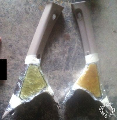

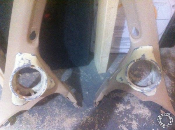

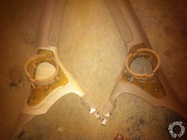

stated with a fiberglass base.
2007 Nissan Pathfinder, Fiberglass Projects -- posted image.

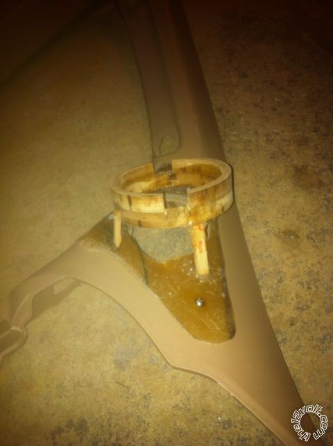

The speaker rings are router-ed from 2 pieces of 1/2" mdf glued together.
my goal was to mount the as deep as possible into the panel so the pods wouldn't block my view.

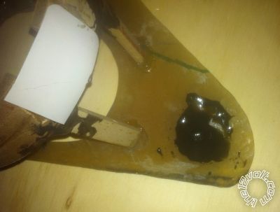

Mixed up some JB-Weld to put over the screw heads to secure them to the pod base plate.

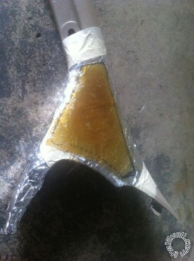

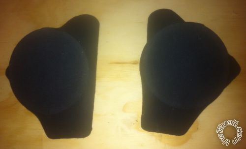

Used a old t-shirt and hot glue to wrap the pods. I was planing to use fleece but the curves and small size of pods made very difficult to rap around. I prefer hot glue over other methods because that way i can use a heat gun to undo any mistakes and later after the resin is harden to remove the cloth as close to the edge of the base plate. ( you will see what i mean in another pic.)

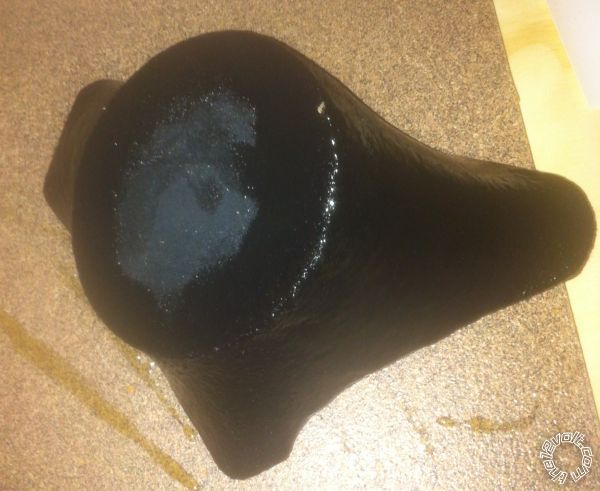

resin is brushed on and harden. downside to using a t-shirt is weakness, fleece will hold more Resin. Next step is to reinforce the pods from the inside with FG and poring resin into the pods.

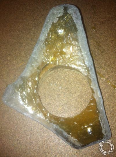

All done with the back and fill with resin on the inside. I us a small heavy plastic cup and poured the resin in and use a heat gun on low to set the resin a bit faster to get it thick on the inside. Also because i used hot glue on the backside of the pod. it was very easy to use a heat gun to peal back the cloth to the edge and just dremel it flat and smooth. Saves a lot of sanding time. Now the pod is ready for Evercoat, sanding, and more sanding. I plan to use a texture primer and then paint to match the factory OEM A-pillar. The Krylon plastic beige is dead on with the Nissan factory color.

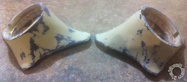

up late last night working on the pods.

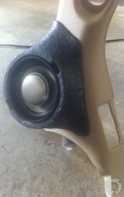

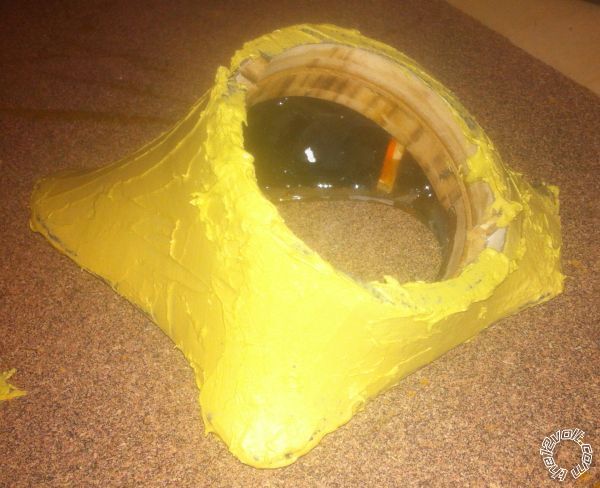

tried out the new Bondo gold. Set time is 5 mins and sand-able after 15 mins to cut down sanding time after it fully cures in ~30 mins. I sanded with a 80 grit. excess came of very easy.
after bondo fully cured. Hand sand it with 120, 200, final 400 grit.
quick test fit

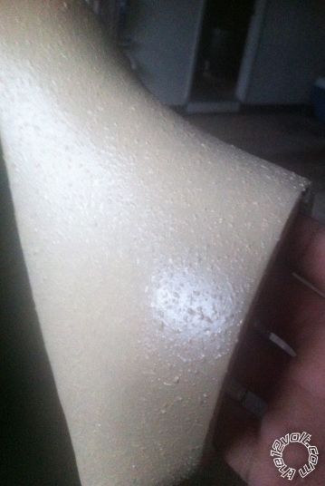

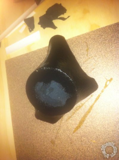

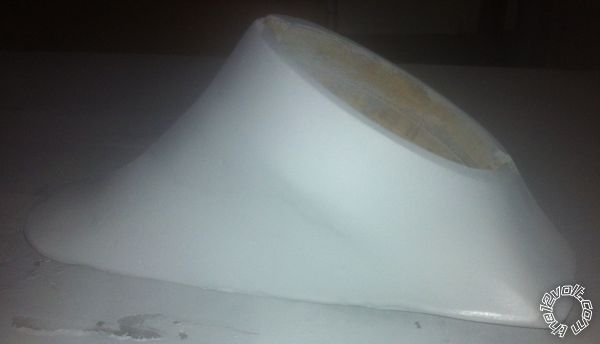

Cleaned up with alcohol and compress air. let it dry off for 10mins or so. Then put 4 light coats of primer 10 mins apart as per can. I used a fast dry primer that was wet sand-able after 20mins :) . Wet sanded with 800 then 1000 grit. Don't for get to soak the sand paper for 30mins at least. Will let them sit for a day or so then its time for the texture paint and clear coat. *note that you don't have to go pass 120 grit sandpaper if you use texture paint, I was undecided on the finish!!!!

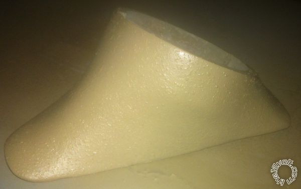

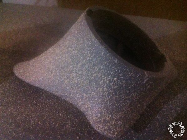

almost done.....
I put a light coat of stone efect spray on to give it a texture and then 3 light coats of the beige coat. Let it dry for a few days and the 2 more light coats of beige and then 3 to 4 light coats of flat clear coat.

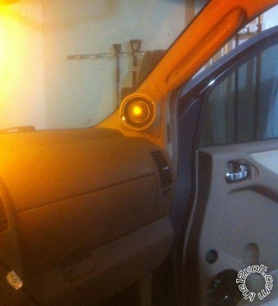

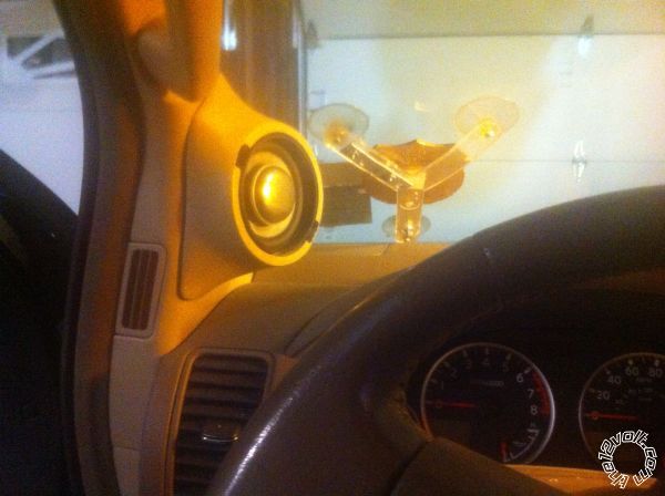

Finished the pods over the weekend. All that's need is now the grilles. Looking for some 5 1/2 or 6 1/2 mess grilles to cut and form them. Will show you guy a easy way to make snap in grilles for your flat speaker ring to.
Here they are install and wired.
Sorry for the bad pic. (was taken at night)
Doors are next up.
