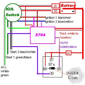

I'd forgotten that Kenny posted that so that's your pictorial, here's your layout.
On the relay, standard Bosch/Tycho 4 or 5 terminal 87a not used, available from Radio Shack or any auto parts store.
The diode shown, also Radio Shack is mandatory or you WILL fry all the circuits on plug H2.
An alternative power source would be the thick white wire going to the fuse box.
Cut starter wire 1 GREEN/ black, key side to green, H3/5 and motor side to violet,
H3/4 of 5704.

I posted this in reply to THIS THREAD Maybe you guys can help me out? Im just concerned that every person gives a different way of doing it and I want the Right Way...

POSSIBLE RELAY WIRING VARIATIONS
"Wiring 1":
    Connecting
+12 volt constant "connect" relay pin 86 and 87
Viper 2nd starter wire "connect" relay pin 85
relay pin 30 "connect" second starter wire on the truck
*** i used NO diode or any extra fuses during my installation *****[/QUOTE]
"Wiring 2":
Diagram
H3/4 of 5704.
"Wiring 3": (In Previous post ^)
Diagram
85 goes to a body ground
30 goes to 12 volts "I connected mine with white with blue stripe."
That is your 12 volt 50 amp circuit. You have 2 12 volt wires.
87 goes to your 2nd starter wire
86 Starter 1 wire on ignition switch
Starter 1 wire on your remote starter as well
"Wiring 4": (As seen in Original Post)
Diagram
Take some extra wire (6-ish inches) and solder it to pin 86 of the relay.
Take another piece of extra wire (6-ish inches) and solder it to pin 87 of the relay.
Now solder on one of the 20 amp inline fuses to the wire coming from pin 86 of the relay.
Solder the other 20 amp fuse to the wire coming from pin 87 of the relay.
Solder the Viper’s H2/18 (violet / YELLOW) wire to pin 85.
Solder some extra wire (12-ish inches) to pin 30 of the relay.
"Wiring 5": (As seen in a reply to OP ^)
Diagram
Please, if you understand this crap, clarify which will NOT fry my electrical system but WILL work as intended.

The answer is "There are many ways to create a Starter2 output for the Tacoma".
I like Howards relay suggestion and wiring.  Here is an updated diagram :
2010 toyota tacoma, remote start -- posted image.
Mike M2
Platinum - Posts: 2,652
Joined: June 29, 2005
Posted: January 01, 2013 at 6:14 PM / IP Logged
Do it they way Kreg is showing you. I have wired literally hundreds of second starters this way...

Posted: January 02, 2013 at 4:25 AM / IP Logged
Thanks guys :) I can finally get going on this thing! Hopefully I have it all done by Sunday. I am going to be taking my time and soldering/heatshrinking everything!
