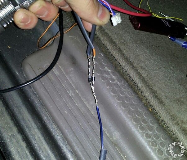

The 1/4 sec double pulse you mention of your R/S is only to the unlock wire. You could diode isolate the unlock wire and connect it to the vehicle's disarm wire & set the R/S unit to double pulse unlock.

afridihamid, do you mean splicing the unlock wire into two and connect one of the wires to the car's disarm?

afridihamid
Member - Posts: 29
Joined: October 30, 2009
Posted: December 20, 2012 at 11:53 PM / IP Logged
Yes, this will give a double pulse to the unlock and disarm wire simultaneously.
See the picture below for reference.
For your application, the white stripes of the diodes will be towards the R/S unit.
r/s not disarming oem alarm -- posted image.
You can simply cut the disarm wire close to the R/S unit and connect it to the isolated unlock wire.
