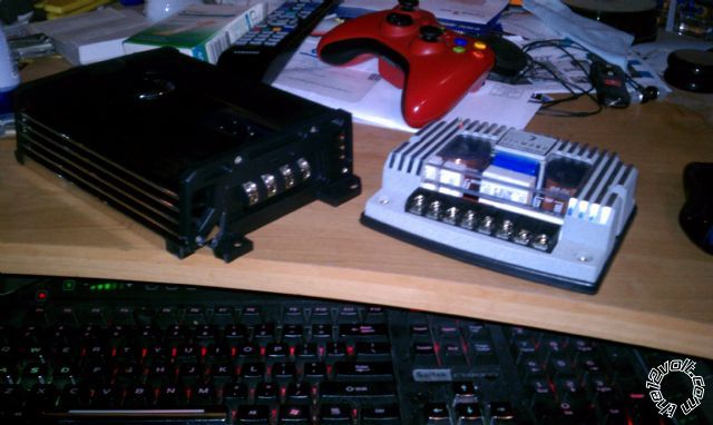

dead amp, need new recommendations - Page 3 -- posted image.
this is the reason why i dont use my passive crossovers, the other crossover is a regular diamond HEX crossover and its pretty big by most standards, the HEX PRO is like a small amp.

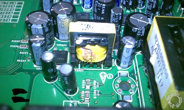

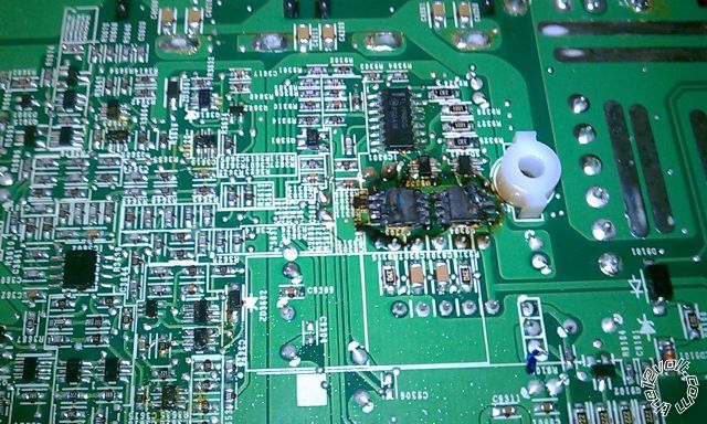

ok so i took apart my alpine and i want to know if this is fixable:
the board is burnt on the top and bottom in the same spot. i dont know what side started burning first but the bottom looks like it got the worst of it with those two chips being almost completely burned.

I say again, not using those crossovers because they are large is like not installing a subwoofer because it requires an enclosure. I highly recommend finding a way and I bet the system sounds better...
As far as repairing the amp, while I'm sure it is possible I'd answer the question "why did those ICs fry?" before I spent any time or money on it.

yea ive already asked myself that question and i have no idea. i dont know enough to even begin to think about what these parts even do. they seem to be part of the power supply side of the amp but that is just a guess based on their location.
