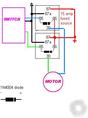

Have a 32 ford  w/ power windows.  Motors are two wire style polarity reversing style
Connected them using two relays according to relay diagram, # 49.
When I release the switch, I am getting some kind of backfeed or surge in my gauges.
Is these a diode /filter I should install to stop this ?
thanks
Lawrence Thornton
Posted: February 25, 2013 at 9:37 AM / IP Logged
What do you mean by "according to relay diagram, # 49."?
I'm assuming the answer is 1N4004 diodes, aid across the coil, 85 and 86 with the bands towards the coil +.

relay backfeed? -- posted image.
Used this one.
Sorry, will correce location I am in South carolina.
Lawrence Thornton
Posted: February 25, 2013 at 10:40 AM / IP Logged
OK, here's the that diagram corrected using the proper relay format:-

Thanks !
