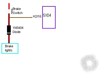

1) Do you have LED brake lights?
2) Never use a Bitwriter in panic, I never need one and I'm now doing about 2+ 5X04s a week.
3) You should be able to restore or unzap the unit, by unlocking remote access via the Bitwriter then relearning the remotes.
No disrespect but as far as I'm concerned, giving any one but experienced pros access to Bitwriter, ESP, Wizard etc. is like giving a 4 year old an assault rifle.
Posted: March 18, 2013 at 6:06 PM / IP Logged
Once sorted, try this on the brake line:-
