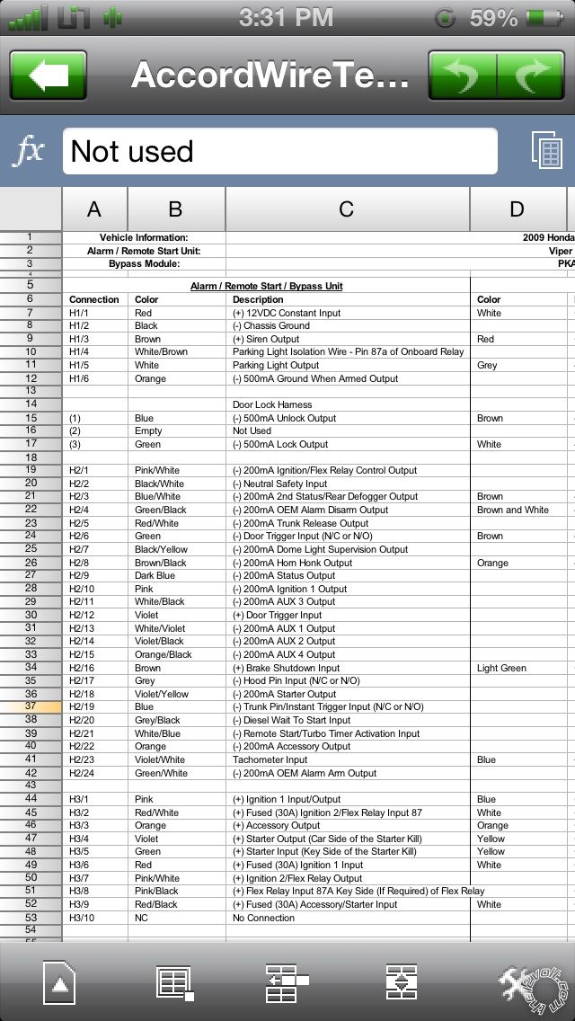

Posted: May 13, 2013 at 2:32 PM / IP Logged
viper 5904, keeps trying to start car -- posted image.viper 5904, keeps trying to start car -- posted image.
Here's what I have so far. Sorry for the pics, doing everything from my phone.
Posted: May 13, 2013 at 5:23 PM / IP Logged
3 things stand out immediately.
1) By-pass? Isn't one needed for this vehicle. 556UW
2) Key sense use the H2/9 dark blue for both by-pass and keysense, white at ignition switch plug and diode separate.
3) H3/7 Pink/white to red at ignition loom program it as ACC 2.
Next question does the factory alarm kick off or the 5904 because you also need to disable the factory alarm.
Disarm brown (key unlock) and white (unlock detection).
Diode separate, double pulse NEG (-) power window master switch, gray 37 pin plug, pins 29 and 31.
