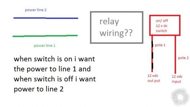

ok so i have used diagrams in this site a few times and really love this site. im no pro but this site has really helped me out on other projects. but i need a little more detail this time. so this is on a 2006 lincoln navigator. im installing an easycar e8 system with push button start. instead of cutting the stock ignition wiring and routing it to the alarm brain i want to route it to a switch, toggle type, on/off. so i think i need a relay so that when i use the toggle "on" will use the alarm system and push to start, but if i flip it "off" i can use the standard ignition with key and bypass the alarm. i know which wires to tap, and to bypass but in not sure how to make an interface for this switch. wire a relay to switch from one source -- posted image.

oh also the "bypass" switch will be mounted hidden in the engine compartment. its really just in case the alarm fails, or start button breaks or something, so that i will have a backup option to just use the key and start it normally with no alarm so im not stranded. the " line 1" for example would be the power to the alarm brain. and the line 2 would be the feed to the stock ignition switch. if i can give more detail or am not clear enough please let me know

I'm only responding to the "switch on the #1 on & switch off #2 on" statement.
I'm ignoring ALL other text.
You have just described an SPDT relay. ie,
85 GND
86 switch output
30 common (ie, +12V supply, or line out)
87 line 1
87a line 2

thats all i needed to know thanks. i know i saw what looked like a farily easy diagram for the spdt in the relay section. i just didnt know which line would go where. i dont quite understand how relays work entirely, even after looking into the section on here for it.
