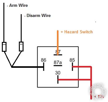

Yes, it should. You would have to tap off of them. But if you use those, you will need to use a relay as Chris mentioned and you would also need to diode isolate them. Attached is a diagram on how to do this.
Otherwise, you can use the parking lights but then the turn signals would be on at all times the parking lights would be on....not just for arming/disarming.

I got around to doing this but one thing i'm noticing is that upon arming the car, the turn signals flash once followed by another quick flash. Disarming the car, the signals just flash once. I was hoping that they would flash in sequence with the parking lights
sparkyssb
Copper - Posts: 205
Joined: March 09, 2002
Posted: December 03, 2013 at 11:35 AM / IP Logged
Your feed is powering the hazard flasher relay and it sounds like the Viper pulse output for the arm is longer than the disarm. I don't see any other way of getting around this unless you can figure out what wires you can tap into AFTER the relay. You would probably have to tap into each turn signal wire. Of course using more diodes to isolate.
