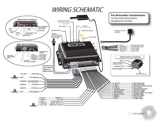

So looking for opinions on using D2D (2way) or W2W on Fortin EVO-ALL and Autostart/ProStart RS?
Is D2D reliable?
from the Fortin website you can use D2D with Fortin/Autostart if you enable it in the R/S config as xpresskit. confusing since it does have Fortin as an option.
https://ifar.ca/en/support/getting_started/151-autostart_orbit_viper_d2d_communication_with_fortin_evo-all.html
Also the RS is equipped with two bypass ports one for ADS/Fortin Bypass and one for xpresskit. Which one do I use? The Tharness from fortin has both connectors. Can I plug in both?d2d 2 way vs w2w fortin evo all -- posted image.

I don't use ProStart, so I have no direct knowledge / experience of their functionality with D2D.
I have heard that D2D is working better.  Used to be a major headache.  It still will be difficult to test / troubleshoot if it gives you problems.
As long as the EVO-ALL is flashed with the DBI D2D option selected, it should work in two-way D2D mode with your ProStart.  The ProStart does have the Red DBI D2D port ( and you should only plug the EVO-ALL harness into this port, not both ).  Give it a try, it shouldn't damage anything and if it has problems you can always switch over to W2W mode.
