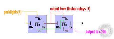

Hey Guys, my father-in-law has an older project car that he has built for the ground up and has asked me to do the wiring. 12v system.
Now, he has chosen to use two LEDs on the front wheel ferrings for usage of a park light and turn signal purpose. One LED per side of the vehicle. LED has a single input.
Basically I need the LEDs to be able to turn on with the park lights and flash with the turn signals. I've worked through 9 different revisions of my circuit and have come up with one final conclusion. However, I come to you guys today to see if you can pick it apart and even possibly make it more efficient.
I have figured that I need 2 SPDT relays per side of the vehicle so the diagram below will be only for one side of the car. I'm sure that you guys can use your imagination for the other side of the car.
So without further ado, thoughts?
parklights and turn signals as one. -- posted image.

Erm. Nevermind. I traced out the lines and if the park lights are on then it will have issues flashing. I might need to look deeper in to this… :(

Soooo much simpler to use separate lights as do most car manufacturers, and also cheaper. parklights and turn signals as one. -- posted image.

Hi,
Use this: https://www.the12volt.com/relays/page5.asp#pts
Modify it by taking the '+12 volt from turn signal' and connecting it also to terminal 87. Don't use the connection labeled 'fused +12v'.
Connect the parking light wire to terminal 87a. Adding a resistor to the parking light input can reduce the current to the LED, dimming it.
You may need to adjust the values in the circuit depending on the relay used. Hope this helps.

@harryharris - Definitely easier, but not nearly as cool… plus I wasn't the one who built the car, lol.
@ween - thanks! I'll give that a try! I like the idea of using less relays to achieve the same output. Much appreciated!

Have a look at exLED's TPC Module Ver.2 - 2Color (2Way) Turn + Position Module.
They have other versions if that's not the correct behavior.
Otherwise to do what you want to do, you either need to move the flasher can so that the indicator switch switches relays that connect the can to the relevant flasher whilst disconnecting the park (or stop or reverse) signal to the LED/lamp; OR incorporate a timing function (ie, turns off the park/clearance/stop/reverse during the flasher on & off cycles).
Those exledusa units do the latter.
You could build your own version using a PICAXE 08 (08M2) for maybe $5 - $10 but that requires some DIY circuitry, programming (or cut&paste) skills, and a serial interface.
