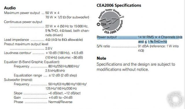

Pioneer can say 50 watts all day long because there is no law against lying about the wattage. If you look closer to the specs section of your owners manual you will see the picture I have posted where they print the more accurate CEA compliant ratings (google it to learn more)
advise on type amp needed for system? -- posted image.

it sucks that companies exaggerate about how much watts their speakers have, i did'nt know that the real wattage was shown in the specs page, like the example you showed on that image.
