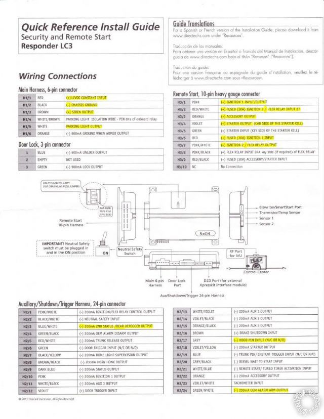

today i received my viper 5706v with DBall2, and from the viper guide i figure out that the wires that should hugged up is as in the image below with yellow highlights, please i need to make sure of this first step of this installation

Posted: August 22, 2014 at 5:38 PM / IP Logged
Quick and dirty answer because I can't read any of the above.
Just go to Xpresskit.com, punch in your year, make and model and follow their diagram, that simple.
