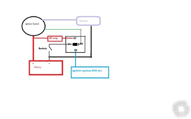

Here's a simplified diagram using a relay and a single pole on-off switch.
The black wire to relay 85 can be a thin gauge and the switch can be low current. The quenching diode, actually not needed in this method though for safety etc. is a 1N4004. The relay is a standard automotive relay I showed a 4 pin but the more readily available 5 pin can be used, just don't use 87a.
The 40* amp fuse is mandatory, you can earth the black to any good local earthing point though I've shown it going back to the battery for convenience.
Car parts suppliers, Maplin etc. hold all the parts.
The switch must be on/off latched NOT momentary.
This will shut down your engine immediately.
*Measure the current draw across your ignition circuit.

Hi Howie
Thanks for the quick reply.
With this we would have a open / closed isolator switch at the positive battery terminal.
By opening this isolator would that kill the engine?
In your diagram where you have 'starter' would that be the Alternator?
Would you pass the return from the Alternator through a resister to earth?
Posted: August 17, 2014 at 3:20 PM / IP Logged
No it's the starter did I mention alternators?
Forget the alternators it's irrelevant.
To stop a petrol engine, interrupt the ignition. That's it.
Why add complications?
Resisters, alternators? Why over complicate things?

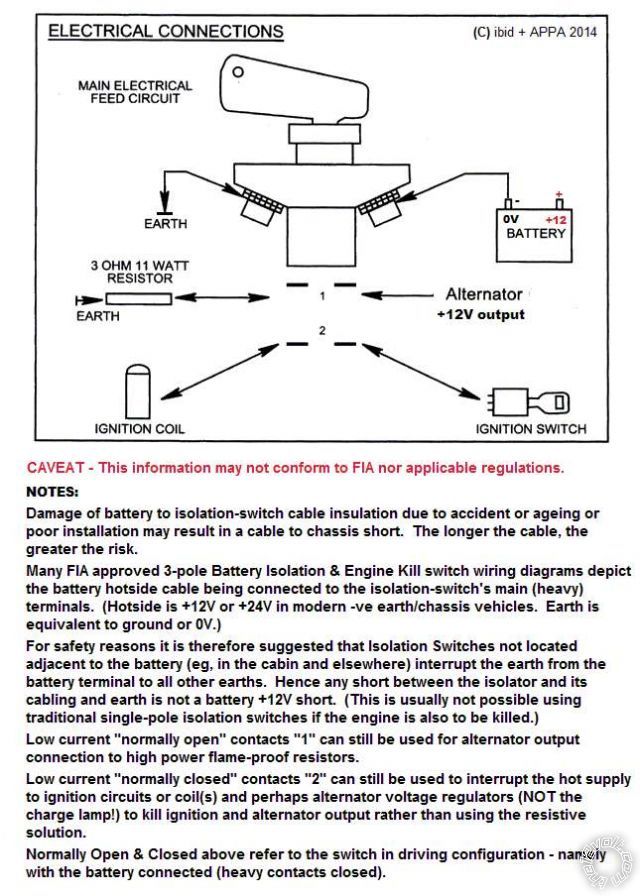

Additionally, whilst the 3-pole FIA approved isolate & kill switch FINALLY solves issues with combined isolate and kill switches (read my posts elsewhere for the stupidity of using a traditional single pole battery isolator switch to ALSO kill the engine), most wiring diagrams I have seen still use +12V (hot side) isolator which IMO is sheer stupidity unless the isolator is adjacent to the battery only.
The hot side +12V interruption is ironic since the 3-pole FIA switch enables the far less risky GND (earth) interruption that is so preferred.
Below is a diagram that shows the FIA switch using the normally accepted "SAFE" GND isolation of the battery -ve terminal.
Other than its caveat, its notes can be ignored if you are happy with the resistor method of killing alternator output (that's the "step load" change I sometimes refer to in driving without a battery connected).

What this guy needs is when the Tech Inspector turns off the battery cut off at the rear of the car with the engine running, the engine dies, AND the battery is simultaneously disconnected from the car's electrical system. That's all he's after.
The systems I've set up for NHRA rules (same requirement as yours, the engine must die) utilize a second set of nominal 20 amp contacts in the battery cutoff switch. These contacts are wired in series with the alternator FIELD, excitation, or 'turn-on' circuit. Depending on the alternator type and model, this may be easy , difficult, or damn near impossible to implement. It depends on the construction and connections of the regulator / alternator system.
Howie's circuit will also work, with the addition of a dual-circuit switch, the big contacts for the battery, and the little contacts for the relay. You would only have to run a single small gauge wire forward for the relay control.
As far as not being able to run additional wires to the rear of the car, you're going to have to find a way to do so. There's no way to accomplish what you need to do without additional wires, or the second set of contacts to interrupt the alternator field or turn-on. (Or the "howie method" ignition interrupt relay).
Running the alternator B+ output directly to the battery B+ terminal, and fitting a "zap-stop" diode to the alternator output terminal would work, BUT the alternator wire will always be hot, and not switched by the cut-off. Not ideal.

I pointed out that it has traditionally not been a "that's all".
In my competitive days, GND break systems were knocked back because the idiots thought the isolation has to be on the hot side. I (or others) managed to have the relevant authority add "may be in the GND side" after demonstrating how hazardous their implemented hotside isolation switches were. And that was when the switches only needed to be in the cabin - NOT is a rear corner which was typically the opposite end to the battery.
Later came the even stupider single switch combined isolation and engine kill. That require hotside switching with the alternator heavy (B+) still connected to battery hot (+12V) which was not regarded as isolation by many.
A diode IMO is not an appropriate solution for various reasons.
The FIA-approved isolator & kill switch is the first commercially offered "isolation" switch I have seen that enables BOTH isolation and engine kill in accordance with safety requirements in a reliable and safe manner. My only surprise is that over one third of a century down the track we seem to be back to hotside isolation, hence the GND isolation method offered above.
The DPST switch you linked is another (even if it doesn't kill self exited alternators and hence their engines).
Multiple FIA-approvesd switches can simply be daisy-chained in series just as the original single-pole isolators could be. (Yes, I have seen hotside +12V dragged from the front-right battery to the rear left corner of the vehicle and then back to the front starter motor!)
The exception is the alternator kill resistive circuit but I'd expect it's acceptable to use a relay that connects a (parallel) resistor actuated from the additional 'isolators'.
