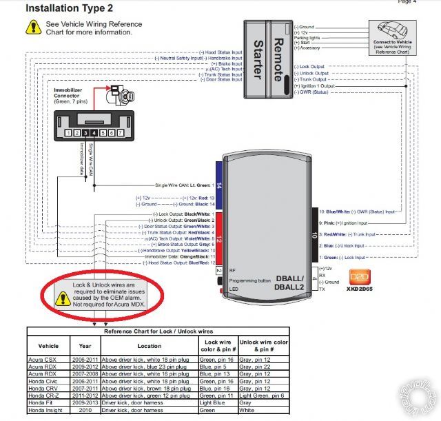

On the dball2 type 2 instructions, I get this odd note saying this about the lock/unlock outputs:
remote start 2010 honda crv -- posted image.
So here's my question, is it as simple as what they say? I was under the impression that the output on the dball 12 pin connector only had a 500ma output, which isn't much. Do I go on blind faith and connect the wires as they say, or do I install isolation relays?

No relays required. The door locks in the car are low current negative trigger.

bingo, the wires in that you're tagging will operate the relay in the vehicle.
Look in the pictorials for the 2007 civic. The cars are almost identical.
