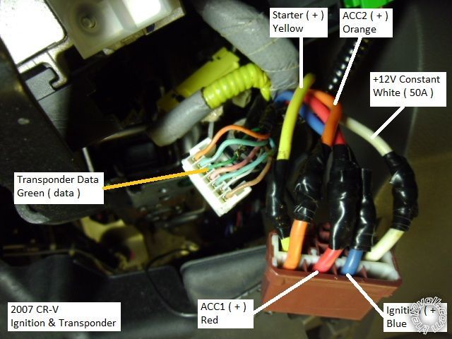

I am confused as to which wires need to go to my ignition wires for my 2008 Honda CRV. Here are the stats for the viper 5706v alarm -
viper 5706v ignition wiring for 08 honda -- posted image.
Here are the wires for my ignition on the Honda-
What what wires correspond to my wires on the ignition ?

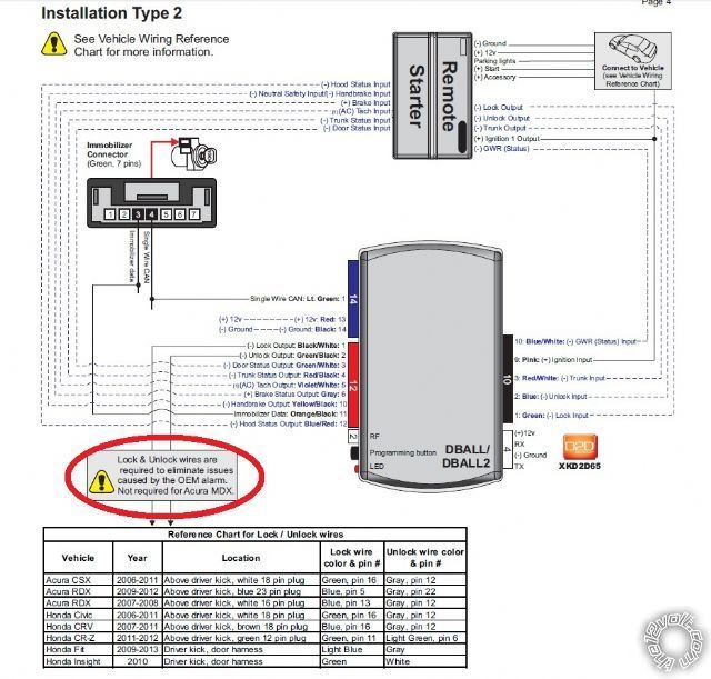

Also, where would I tie in the pink wire for the dball seen below?

1) Due to your lack of understanding of how a basic circuit works, I would consider reading the manual that came with your viper. I'm sure there's a member that could layout all the information required and spoon-feed you the answers; however this is where problems begin, as most users like to do what children do! simply matching colours of wires based off others inputs. If you understood basic circuity, you would be compelled to test your wires, ergo figuring out what wires would need to be connected from your viper unit to the vehicle... Correct me if I'm wrong.
1b) The answer is written in the diagram. It says connect the pink wire to the ignition wire on the car. In this case (i'll give you something to match) The pink from the dball, will go to the pink on the viper (same manufacture)
2) If you have done remote starters in the past, then you should already have some background knowledge no? Truthfully, I don't believe starter installs have changed for any regular key cars. In addition of course the bypass module/canbus, etc, but with time comes new technology to simplify the install. PTS of course is a different animal.
moving on. Kreg has a very detailed pictorial here: https://www.the12volt.com/installbay/forum_posts.asp?tid=133609
that will have all necessary connections you need for the larger gauge wire.
To speed up the learning curve from viper to car.
RED / black,Red,RED / white to white
pink to blue
orange to orange
violet to yellow (unless you want a starter disable) the cut the wire green towards plug, violet to car.
pink/white to red (not required only for radio)
don't forget the door lock wires from the dball to the car. its a mandatory connection.
do yourself a favour and test your wires with a dmm rather than playing "lets match colours"
