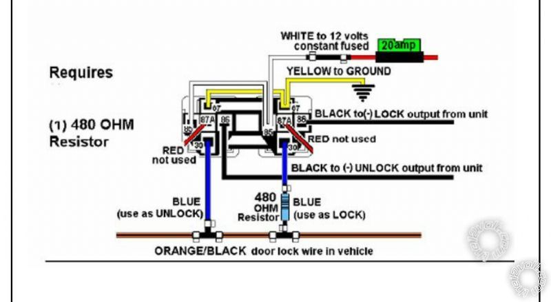

Thank you guys! One question I have is that I have seen the other posts that say I need a 480 ohm resistor on the lock side with a relay system. The problem I am facing is that I cannot find a 480 resistor. will I need to combine a 10 ohm and 470 ohm? Also, does it matter if it is a 1/4 or 1/2 watt resistor?
Posted: February 26, 2015 at 8:57 AM / IP Logged Link to Post Post Reply Quote howie ll
1/4 watt is fine, 470R will do.
If you buy a cheaper unit with only 2 lock/unlock wires you'll need a DEI 451 relay to drive or overcome the resistor.
This comes with a wide selection of resistors.
If the lock wires are 6 that means internal relays, you only need the resistor.

Posted: February 26, 2015 at 12:47 PM / IP Logged Link to Post Post Reply Quote drewart
Howie,
What do you mean only 2 lock/unlock wires? For example using the Compustar CS700-A is this one that would need a DEI 451m relay?
As for the DEI 451m relay is it the same as wiring two relays together? I have a diagram showing how to do this and was planning on using two relays, would the 451m make it easier?
Sorry for all of the questions I just want to absorb everything I can. Thank you for everything!
Posted: February 26, 2015 at 12:56 PM / IP Logged Link to Post Post Reply Quote howie ll
Yes you can use 2 relays, the 451 plugs directly into DEI product, not sure about Compustar, also smaller size, plus the resistors, as an installer I much prefer that to two separate relays, except if the unlock is a direct NEG switching you'll only the relay on the lock side.

Posted: February 26, 2015 at 2:25 PM / IP Logged Link to Post Post Reply Quote drewart
This is the diagram that I have. From what you said I guess that I would only need one relay? Keyless entry and alarm, 2002 Chevy Impala -- posted image.
