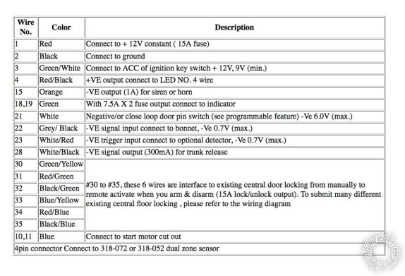

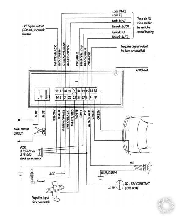

 I have fitted my Viper 5706v (Basic- alarm only, i intend to do remote start some other time) into my Nissan Patrol GU3, but are having troubles with door lock\unlock not working.
Initially a Vision VAE 318-1800 alarm was inplace,,, So I decided on a changeout to a new Viper. Everything is working as intended apart from door locking\unlocking,,, going from the Vision VAE318 wires already installed & the wire diagram,,, show that remote locking was pins 30 Green\Yellow - Lock "C" & Blue\Yellow pin 33 Unlock "C". I wire these to resemble what was initially installed on the Vision VAE318 as to resemble to the VIPER (Door Lock 3 pin connector),,,,,PIN30= GREEN (-) 500mA LOCK OUTPUT & PIN33= BLUE (-) 500mA UNLOCK OUTPUT...BUT NO go. Any ideas would be appreciated.
