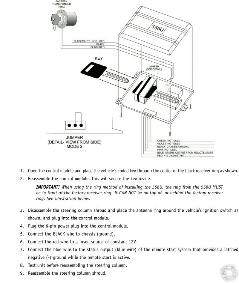

Will the 556UW work in conjunction with the dball2 for lock/unlock/trunk features? If so how do I wire it?

Posted: July 27, 2015 at 10:32 AM / IP Logged Link to Post Post Reply Quote lopezjorge123
Viper 5706v won't start my 2010 Chevy Malibu -- posted image.
According to the 556uw instructions, all that's needed for this to work is power,ground, and GWR- signal. Will tapping into the dball's gwr interrupt any functions?
Platinum - Posts: 7,828
Posted: July 27, 2015 at 7:49 PM / IP Logged Link to Post Post Reply Quote kreg357
If you are not using the Vipers BLUE/WHITE (-) 200mA 2ND STATUS /REAR DEFOGGER OUTPUT, use that as the GWR input to the 556UW.  Default programming is 2nd Status.  The DB-ALL2 will be used for the "convenience" features.  I've never tried it that way but I believe you can undo & disconnect the RED / White cut on the transponder plug.
