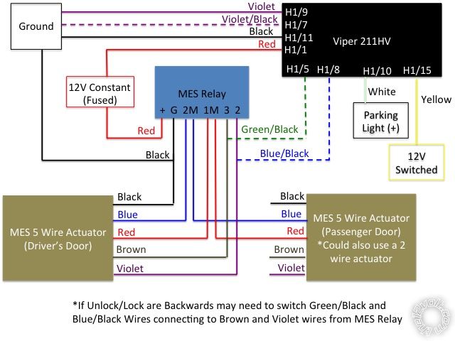

Can someone confirm if this diagram I made seems correct? I'm installing MES Actuators with a Blue MES Central Locking Timer Relay in my 1969 Camaro. I'm adding a Viper 211HV to have keyless entry. I've read that having 5 wire actuators in both doors can cause headaches so am planning to only hook all 5 wires up in the driver's door and leaving the passenger door as a "slave" actuator. Thanks in advance!

Yes but in practice I'd leave out the brown and violet gong to the passenger door actuator. If the two actuators aren't aligned aren't aligned exactly you'll find the system won't work properly.
Do as that diagram says, use a 2 wire.

Thanks for the confirmation. It's just a little diagram I whipped up to aid in my install.
I would use a two wire actuator in the passenger door if I was able to find a MES Blue Relay separately. Currently I've only been able to locate the relay as a part of a two door kit that includes the relay, (2) 5 wire actuators, and wiring to install them. In this case (using a 5 wire actuator in the passenger door) I'm planning to only hook up the red and blue wires in the passenger door as the diagram indicates. I'm planning to keep the black, brown, and violet wires completely unhooked. Does this sound like a good plan?
