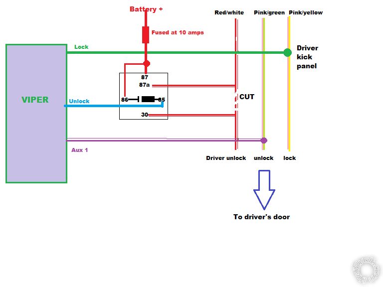

Here's a diagram for priority locks:- taurus_priority_unlock.png
Thoughts:-
The diode shown, 1N4004 is mandatory, it will protect the circuitry of the Viper from back EMF when the relay shuts down.
Note, hold aux 1 for 2 seconds OR Menu 2 feature 9 option 5, sets aux 1 as secondary unlock, you simply hold the disarm button longer or press it a second time.

2) Thanks for the diagram Howie, but I'm a bit confused, since my oem door lock/unlock circuits use relays, do I need to add that diode to them?
Do I need to add a relay to a circuit that already has an oem relay designed/built into it?
Posted: September 09, 2015 at 1:37 AM / IP Logged Link to Post Post Reply Quote howie ll
The pink / YELLOW and pink/green are low current NEG (-) they switch OEM relays.
RED / white is a MOTOR wire. Test, will show 0v at rest, 12V+ for 0.5 of a second on door unlock and therefore needs to be relay driven as per diagram.
The diode has nothing to do with OEM equipment it's to protect your 5706 and IMO mandatory.

Something I was confused on in regards to my post above about the driver door unlock and the use of a separate relay, for others who may read this: My driver door unlock is a separate OEM relay and the all door unlock is a separate relay, so I did not have to wire up an aftermarket/separate relay for the Driver door unlock. I just wired Door Lock connector 1/BK to the ground signal of the OEM relay, worked perfectly. My apologies to Howie for not explaining exactly what OEM circuits I was working with. If you do not have factory/OEM individual door unlock relays, then yes, you need to wire up a separate relay as Howie instructed.
