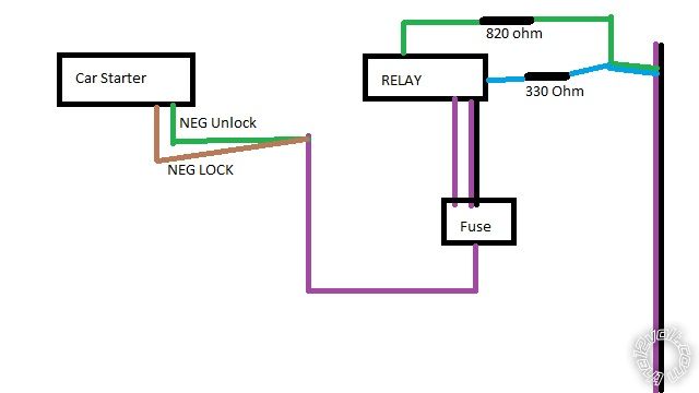

Posted: October 12, 2015 at 8:18 PM / IP Logged Link to Post Post Reply Quote rayf01
Hoping I can get some help here. Not sure if I am doing something wrong.
I received my 451M module. It has 5 big wires, and then three small wires that are apparantly for DEI systems that I don't think I use (they have a little 3 pin connector on them).
Now, the 5 big wires, I believe the WHITE/ Black and BROWN / Black are not use, so I taped them up.
That leaves me with the following, and how I connected them:
Wires coming off the relay:
1. GREEN/ Black - Connected to 820 Ohm Resistor.
2. Blue/Black - Connected to 330 Ohm Resistor.
- I Then connected both of the resistor ends together and then tied them to the PURPLE / black wire under my dash which I think is the lock common wire for my door locks.
3. Violet&Violet/Blck - They were terminated already together in to a fuse. then a single violet comes out. I connected this to the GREEN/ Brown wires coming off my car starter which in the manual says those wires are the unlock/lock negative contacts. I connected it this way because it says input which I assume is input from the car starter?
My only concern is that the violet inputs on the relay say they should be connected to a 15amp ground? Im really confused as if I do that there is no input in to the actual relay then from the car starter...
2005 Dodge Ram W/ CommandStart CS-380i -- posted image.
Also is there a way to test the relay to see if its working? I accidentally connected the three pin connected in to the 556u immobilizer bypass by mistake. When there was a different three pin connect that was supposed to go in to that 556U.
Platinum - Posts: 7,827
Posted: October 12, 2015 at 9:11 PM / IP Logged Link to Post Post Reply Quote kreg357
Not doing too good with the 451M.
First, the 3 Pin connector, cut the end off it and connect the Green wire to the CS380i's (-) Lock output.  Connect the Blue wire to the
CS380i's (-) Unlock output.  The Red wire goes to a +12V constant source.  You can add a 2 Amp fuse if you wish.
Next for the thick wires we follow the Type H diagram.
You have the GREEN/ Black with the 820 ohm resistor OK and the Blue/Black with the 330 ohm resistor OK.  These two wires should go
to this wire :        PURPLE / Dark Green @ driver kick, door harness
The fused Violet wire should go to any solid Chassis Ground.  The other two wires are not used, just cut and insulate them.
rayf01
Member - Posts: 6
Joined: September 16, 2015
Posted: October 12, 2015 at 10:39 PM / IP Logged Link to Post Post Reply Quote rayf01
Well I was definitely a little off hey? I'll give it a go. Thank You.
