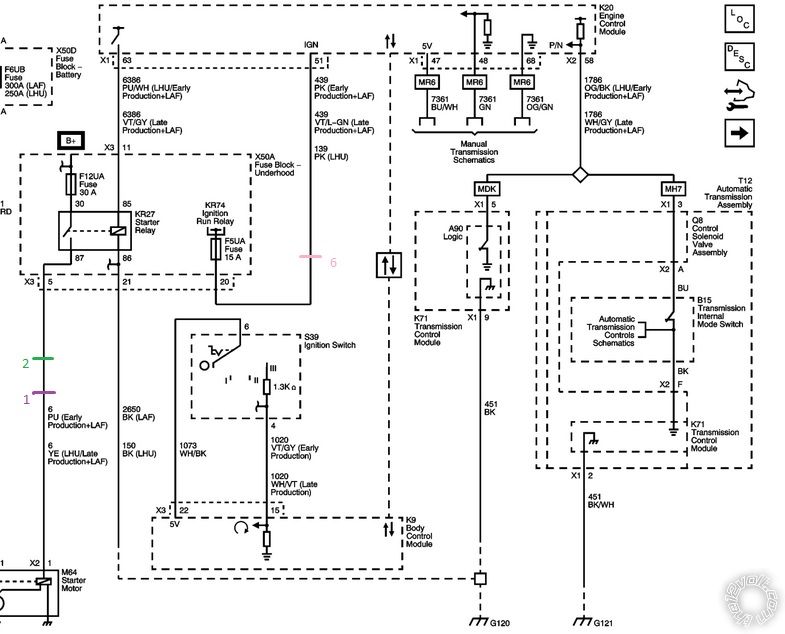

This is what I'm struggling with. When I read the description of this satellite, and saw the heavy gauge wires, I was led to believe that this goes under the hood, and connects to the power side of the respective relays. So Initially I wired this up as follows:
H/1 -- Purple -- Starter Output to Starter (Starter Side) -- Cut wire going directly to starter motor and connected this to the starter side.
H/2 -- Green -- Starter Input from Ignition Switch (Key Side) -- Cut wire going directly to starter motor and connected this to the "key" side.
H/3 -- Red -- (+) 12V Input -- Connected directly to battery.
H/4 -- Orange -- Output to accessory circuit -- Attached to wire that I had dropped down earlier from Ignition Area -- The original wire is Brown in color.
H/5 -- Red -- (+) 12V Input -- Connected directly to battery.
H/6 -- Pink -- Output to Primary Ignition Circuit -- Connected to ignition run relay under the hood.
H/7 -- RED / White -- 12V Input -- Not connected.
H/8 -- Pink/White -- Output to Second Ignition/Accessory Circuit -- Not connected.
Below is the wiring for the starting and charging circuit under the hood.
Avital 5303 2011 Buick Regal -- posted image.
The DBALL2 was flashed with the latest GM firmware for my car, and wired for D2D type 1 mode, basically CAN and immobilizer connections, and the accessory output. I setup the Avital to use the 4 pin port for D2D mode as well, and the transponder code was learned by the DBALL according to it's manual (solid green light, then off).
I am having two main problems.
1) The remote start will not work. The engine cranks, but never starts. I have narrowed this down to a couple of possibilities:
    a) The DBALL2 never gets the signal that the remote start is trying to start the car. from digging in the forums, this could be due to the status wire not being connected between the DBALL and the Avital. Even though the directions say this is not required in D2D mode, others have found this to be the culprit.
    b) The ignition wire on the heavy gauge satellite harness is supposed be connected to the ignition harness at the key switch, and not under the hood. I see that working if the DBALL2 monitors the CAN and sees the engine crank message (if such a message exists) and sends the transponder code.

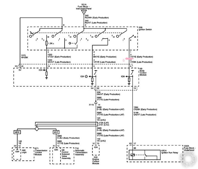

    Assuming b) is the problem, then it's likely I connected the satellite harness wrong. I couldn't find any mention of anyone else connecting the relay satellite in the engine bay and drilling through the firewall to connect it to the brain, for the Avital or any other brand, so it appears it connects right at the key switch. The problem I have with that is that the wires at my key switch go directly to the BCM, and the BCM sends the signal that closes the starter relay, etc. So, I'm slightly uncomfortable with connecting "high current" connections to my BCM.
That's my ignition switch, and where the DBALL2 manual says I should hook up the "ignition wire" of the remote starter, which looks like it's #6 on the heavy gauge satellite. GM's documentation confirms that the #1 wire on that connector is the "Run/Crank/Ignition 1 Voltage" wire. I guess I'm confused primarily about whether the heavy gauge satellite is wired at the ignition or under the hood for this car, seeing as how the signals from the ignition are not sent directly to the relays as they are in older vehicles.

Posted: September 17, 2015 at 8:46 PM / IP Logged Link to Post Post Reply Quote kreg357
Stop right now before anything else is damaged.  I am assuming a Flip-Key vehicle, you didn't specify.
You should be following the DB-ALL2 w/GM10 Ver3.13+ install guide very closely. Do not ad-lib or deviate from this guide. It lists all the wires and the proper connections.
There should be no connections under the hood for the starter or ignition.

Posted: September 17, 2015 at 8:59 PM / IP Logged Link to Post Post Reply Quote bighomie313
So the pink ignition wire goes to the ignition connector then, got it. What about the "high current" power connectors on the satellite? Can I just wire those to 12 constant? The DBALL2 manual doesn't specify. I'm worried that if I wore them to a regular +12 that it would constantly try to pull a lot of current and blow the upstream fuse, I am probably over thinking it though.

H/5 PINK OUTPUT TO PRIMARY IGNITION CIRCUIT   To Regal, 6 Pin Black connector @ Ign Control Switch, Pin 1 Violet/Black
