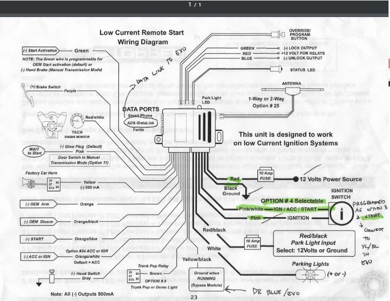

Hi All,
I wonder if someone can give me a hand here before winter hits the ground. I installed a Crimestopper LC1 and Evo all by fortin in our Mitsubishi Outlander 2014 (PTS). I followed the wiring diagram but it seems i have no luck in this. You can hear that the remote is trying to engage but not even a crank and gives me a "electrical maintenance require" in my dash. So I decided to activate the Pink/White for "Start". Engine will crank but it wont start (same error shows in my dash). I'm not so worry about the error as I know that is probably from the remote itself.
Engine Crank, but won't start -- posted image.
Can you guys check the wiring if I miss anything?
Also if anyone knows how to clear my "engine light indicator"?
Thanks

krizeus
Member - Posts: 12
Joined: January 17, 2011
Location: Alberta, Canada
Posted: October 21, 2015 at 12:24 PM / IP Logged Link to Post Post Reply Quote krizeus
Found the problem--- R/S was set to Idata link interface..
Swap cable and connector--- all good
Thanks guys
