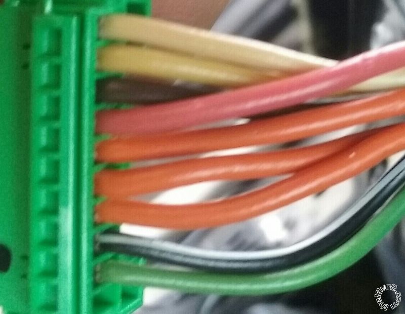

Do i need a relay on my trunk release and any of my ignition wires on this car. Ignition wires are small gauge. I also have 3 orange wires coming out of my ignition harness as well, anyone with a more detailed diagram of what the wires are.

Posted: January 10, 2016 at 3:26 AM / IP Logged Link to Post Post Reply Quote ttimms20
Viper 5906v on a 2000 Cadillac Deville -- posted image.

Posted: January 10, 2016 at 1:07 PM / IP Logged Link to Post Post Reply Quote ttimms20
Ok tested all wires and I'm getting:
White- on in acc, on/run, start/crank
Yellow- on in start/crank
Brown- on in acc, on/run
Pink- on in on/run, start crank
Orange1- on in all positions
Orange2- on in on/run
Orange3- on in all potions
BLACK/ white- nothing
Green- nothing
So off all this I know my
Orange1 and Orange3- Bat1 and Bat2
Yellow- start
Pink- Ignition 1
Brown- acc 2
The Orange2 is saying it's the Acc on the tech sheet bit acting more like the Ign2
The White wire is saying it's Ign2 on the tech sheet but acting more like a Acc wire.
We Ride

Posted: January 10, 2016 at 6:01 PM / IP Logged Link to Post Post Reply Quote mscguy
http://www.readyremote.com/main.asp?action=select&yr=2960&product=Remote%20Start&make=Cadillac&model=DeVille#
mscguy
Copper - Posts: 212
Joined: November 28, 2015
Posted: January 10, 2016 at 6:08 PM / IP Logged Link to Post Post Reply Quote mscguy
I would suggest going to the battery for your +12vdc connections.
Those 2 orange wires you tested that are on in all Positions, share a common 15amp fuse that powers numerous things.
