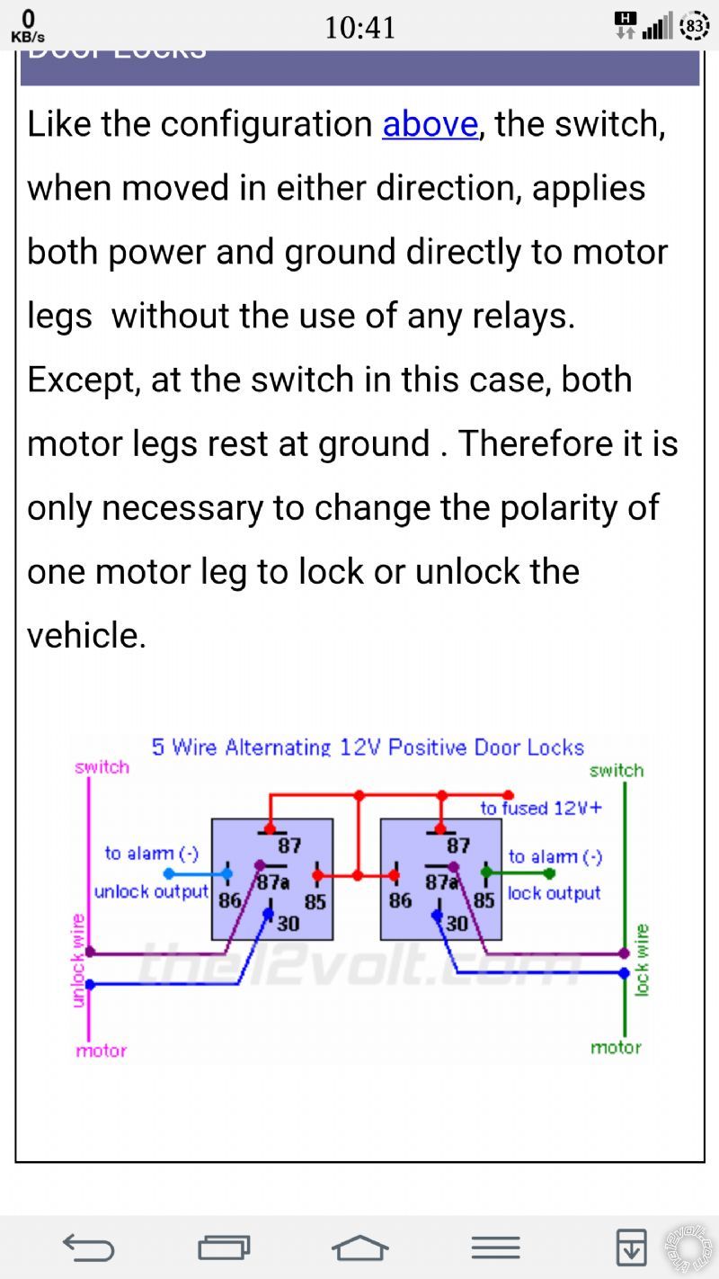

Thanks for reply. Do you mean I have to connect relays as in attachment. 2007 Peugeot 308 Lock Trigger -- posted image.

As I stated unlock wire triggers simply by grounding it. Lock wire I am unable to trigger. I also found wire that drops when lock/unlock and than right back to -12V. It is the only wire that when I cut central lock doesn't work at all. If I cut one of other two(I think lock) than all locks/unlocks exept main door (I am doing that in main door). I only need to figure out how to trigger lock wire. Thanks

Posted: January 07, 2016 at 4:14 AM / IP Logged
That wire, try cutting it it could be a 1 wire open circuit:-
https://www.the12volt.com/doorlocks/page2.asp
The problem is no one in the Auto Electrical trade in the UK wants to touch French cars so no info!
The system I've linked to above I've seen in some Peugeots.
Also when I said motor wires, I just remembered there was a separate unlock motor wire for driver door on the 307.
