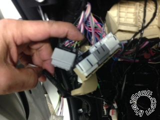

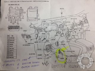

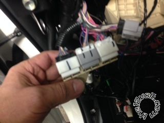

hi there as i said i misplaced those 4 plugs and something weird happened. the costumer reported to me that there was a noise on the left side, like a relay or something trying to engage. i don't know exactly how to describe this noise and i was wondering if i still have the plugs on the wrong position so i have a pic of the plugs on my hands and another one from the toyota diagram ,i really need to figure out if they still off the place please. thanks

I've worked on many Venzas and I can't discern what plugs your holding onto. Did you make any connections to the wires coming from these plugs?

no i don't have nothing connected to it I'm trying to find the right position for those plugs i have them disconnected and not sure how they go back to the right spot got it?they are locate at your left side of the fuse box

hi there i wish that one of these great technicians here would post a pic of a 2015 or another year toyota venza these plugs are on the left side of the fuse box
the only thing i need is to know exactly where these four plugs go in each place
