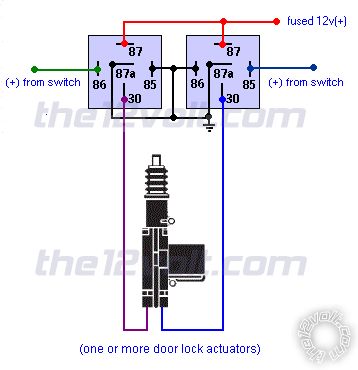

I think you're saying the push button start system is dependent on the lock and unlock signals to enable and disable the push button, correct?
If that's the case, the positive unlock lead and the negative lock lead from the push button system would connect to the same wire going to your door lock actuators (positive during unlock, negative during lock). I would use diodes just to be safe. One issue you may have is with locking the doors after you enter or start the vehicle if you're using a switch or remote, but we can come up with a solution for that.

The unlock (+) and lock (-) are the same wire on the actuator, however each wire of the actuator rests at ground (-) in the diagram above.
I'll assume the push button start system is looking for a pulse from your keyless entry system. On most keyless entry systems the two door output wires provide a negative and positive pulse during lock and a positive and negative output during unlock on the same two wires.
Example: the two keyless entry door lock/unlock output wires are blue and green. During lock, the blue wire sends a positive pulse and the green wire sends a negative pulse. During unlock, the blue wire sends a negative pulse and the green wire sends a positive pulse.
Again, you would be connecting the push button start system's unlock signal (+) and lock signal (-) to only one of the two output wires from the keyless entry. In the example above, they would both connect to the green lock/unlock wire from the keyless entry.

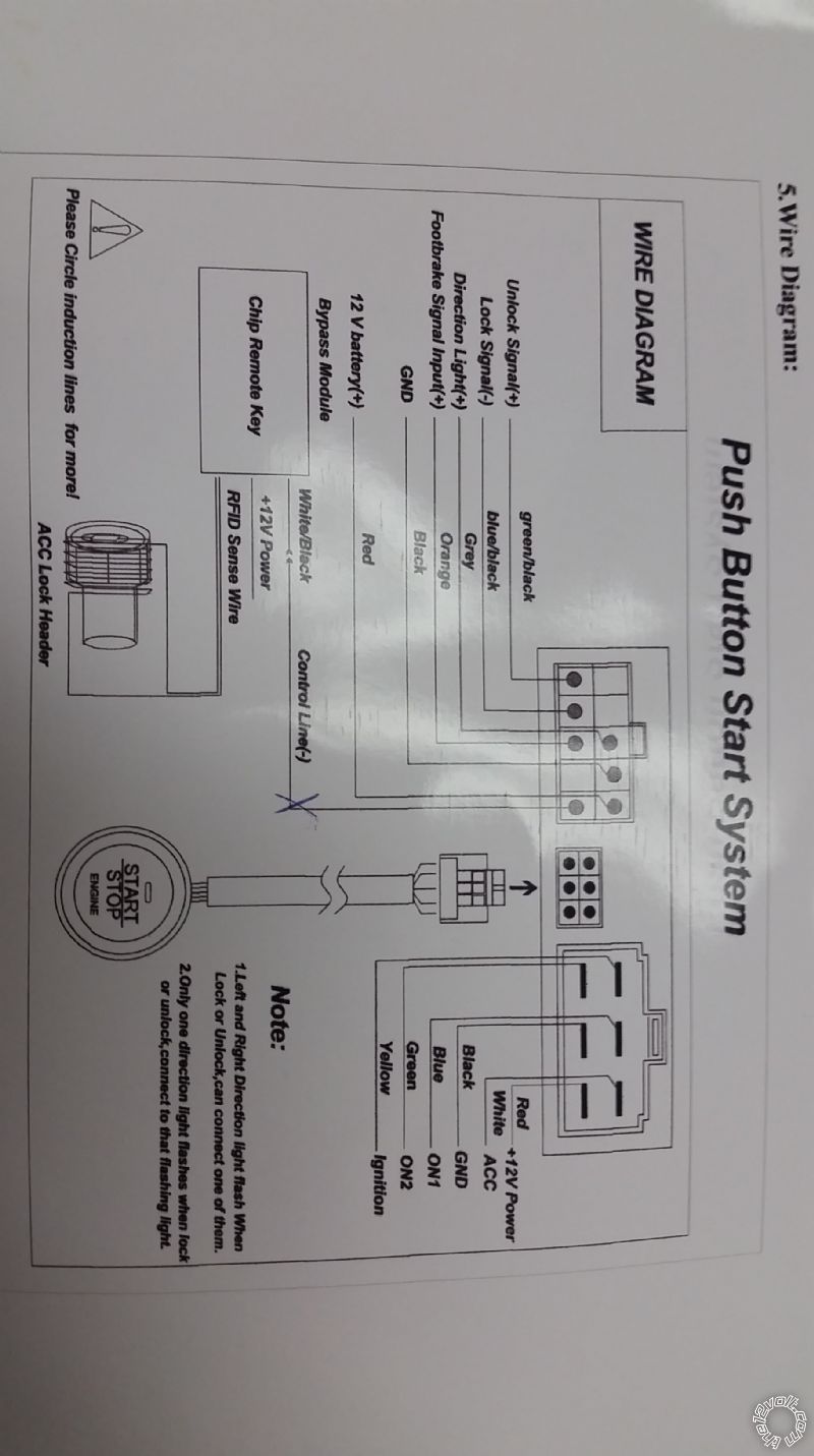

Push Button Start, Reverse Polarity Lock Actuator -- posted image.
These are the remaining directions that were received with the push button start system. One page is for a bypass module but that doesn't apply to my setup since it is being installed on a 1967 Camaro with no such feature. The electric door lock system was from Klassic Keyless. So far the door lock system works great.
As you can see from the attached directions for the push button start system, they discuss function of the system as opposed to installation. I hope this is helpful. At first glance of the directions it looks like it was translated from Chinese to English by someone who doesn't have a firm grasp on the English language.

Your suggestion is to hook up the Unlock Signal (+) GREEN/ black wire from the push button start system to the green wire on the door lock actuator correct? This way when the unlock button is pressed on the remote, the green wire on the door lock actuator receives a (+) signal thus triggering a (+) signal to the Unlock Signal (+) GREEN/ black wire on the push button start system. I would then assume that the push button start system computer control would only need that single (+) signal to activate and turn on in a ready state so when I get in the car, I simply push the start button to turn on the car.
You also suggest hooking up the Lock Signal (-) blue/black wire from the push button start system to the same green wire on the door lock actuator correct? This way when the lock button is pressed on the remote, the green wire on the door lock actuator receives a (-) signal thus triggering a (-) signal to the Lock Signal (-) blue/black wire on the push button star system, correct? I would then assume that the push button start system computer control would only need that single (-) signal to deactivate and turn off the power to the push button start system so when I try to push the start button there is no power and thus the car will not turn on.
But that would mean that both the Unlock Signal (+) and Lock Signal (-) would receive the same (+) signal when the door is unlocked and the same (-) signal when the door is locked, correct? My only question would be whether or not that screws with the computer that controls the on/off function of the push button start system. Not sure if it would but I guess trial and error would tell.
I am just hesitant to connect both wires to the same door lock actuator wire and they both receive a (+) and a (-) signal at the same time. I wouldn't want to fry the computer control module or anything.
I would also be concerned that if it was hooked up as discussed above, what would happen if I turned the car on and then used the same remote to lock the car doors? Would the car die? I guess I could manually lock the doors but that would prove to be a hassle. I guess I could always wire a different fixed button somewhere in the car that would have lock and unlock the doors?
I greatly appreciate your assistance with working through this with me. I just want to make sure I know where I am wiring everything before I cut apart my harness so that I can make this process as smooth as possible.

Before I read the manual and the rest of your post, do not hook up any wires from the push button start to the actuator wires. The blue and green wires I was referring to in my previous post is from a keyless entry system that would go to a pair of relays as shown in the first diagram you posted.
