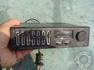

That's the old 5-pin output connectors on that, isn't it? Here is a "reproduction" of the manual. The colors are the same, the catalog number isn't.
Gray or brown is right +
White or green is left +
Black wires are ground for system and speakers.
Does the wiring plug look anything like what you see in the background of this booster? Realistic AM/FM Cassette 12-1930A Manual -- posted image.
