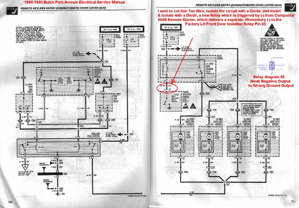

Posted: March 12, 2017 at 11:26 PM / IP Logged Link to Post Post Reply Quote geraldfrank
...Isolating Backup Light Circuit -- posted image.
Dave would appreciate your looking at this wiring diagram to see if this idea has any hope of working. I looked inside the RKE/RAC and there are no relay's inside. All the RAC does is ground this circuit momentarily to cause the unlock of the Drivers door, and a second pulse within 30 seconds opens the other doors. Would appreciate any ideas, thanks Gerald
