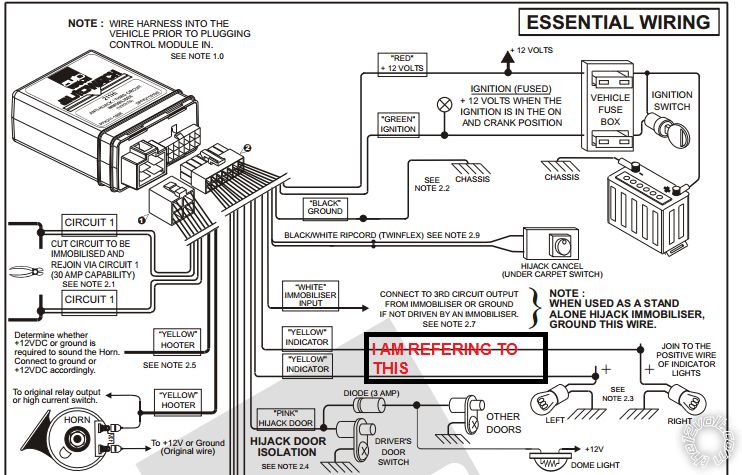

Can anyone please help me find me the location of turn signal wires location and color (LEFT AND RIGHT) on my corolla 2001 as i am on process of installing immobilizer check the screenshot below
thank you

Those outputs aren't meant for turn signals. They are for parking lights. See below.

okay sounds good, or can i use those output to hazard lights instead of parking lights, reason why i want hazard lights as output because my current alarm system is tied the left and right wire channels from the module together and tapped into the park lights, so wanted only signal bars to flash when anti hijack is activated

I suppose you could, but you'll likely have to connect it at the output of the hazard switch before the flasher(s), but no guarantee that it will work as you want it to.

Nope Toyota hazard switches are NEG trigger, use if I remember GREEN/ black and GREEN/ YELLOW, steering column loom or driver side floor loom. TEST.
And yes you can use thosew wire for direction indicators, everywhere in the world bar North America does it this way.
