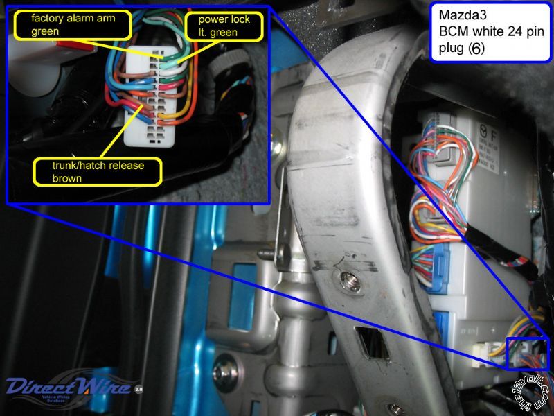

Hey im trying to install a prostart 3471tw on my 2013 Mazda 3, I can't get the trunk release to work with the remote, heres the wire i
spliced into2013 mazda 3 prostart ct 3471tw installation -- posted image.

You need to 5 wire the trunk wire using a relay, and Yes normal that the Prostart will have no idea if the car is locked if you use the factory remote. You will need to use the disarm on the Prostart to disarm oem alarm. (*Pick one, and don't use both.. Use either the Prostart to unlock/lock or use the factory remote*)

Ok I got the arm/disarm hardwired, I can now arm the car now with the remote starter. The horn dosen't honk like on the factory remote tho.
I can't get the trunk release to work, I got the relay wired up. I can hear the relay be activated when I press the trunk release button but its still not working.
Any ideas?
