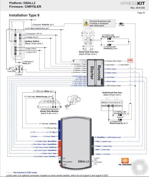

Posted: December 06, 2016 at 7:50 PM / IP Logged Link to Post Post Reply Quote at_viper
2005 Dodge Durango Remote Start Parts -- posted image.
The area's of main concern is the need for the relay and diode and if adding a Viper 4806 or Viper 5501 (4702v) changes the value of these items or if they are even needed at all?
